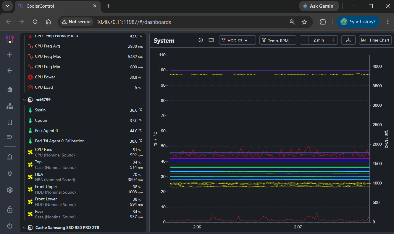

  9. Further, if you are keeping the system in your office, I'd recommend Coolercontrol (Docker) to let you adjust cooling and sound.

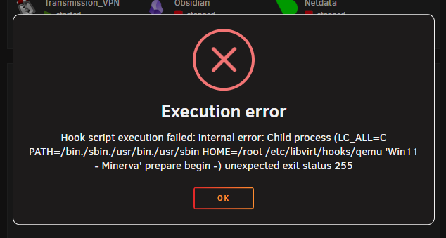

  12. I've been playing, replacing some components and reconfiguring others... But I've clearly messed something up. I have two VMs that autostart at startup: One that uses the Network card (Upgraded) to run the router, and another to run home assistant. Once I log in I can just start the two VMs and they seem to be working fine. I also have a gaming VM that uses a Dedicated SSD, a USB card, and Video card. But it gets launched as needed (Sure wish I could let the server use that Video card when the Gaming machine isn't in use.) I guess I could completely wipe out the vfio-bind and rebuild, but if there error is coming from the config of a virtual machine that might not fix it. Thanks jupiter-diagnostics-20260609-0825.zip
