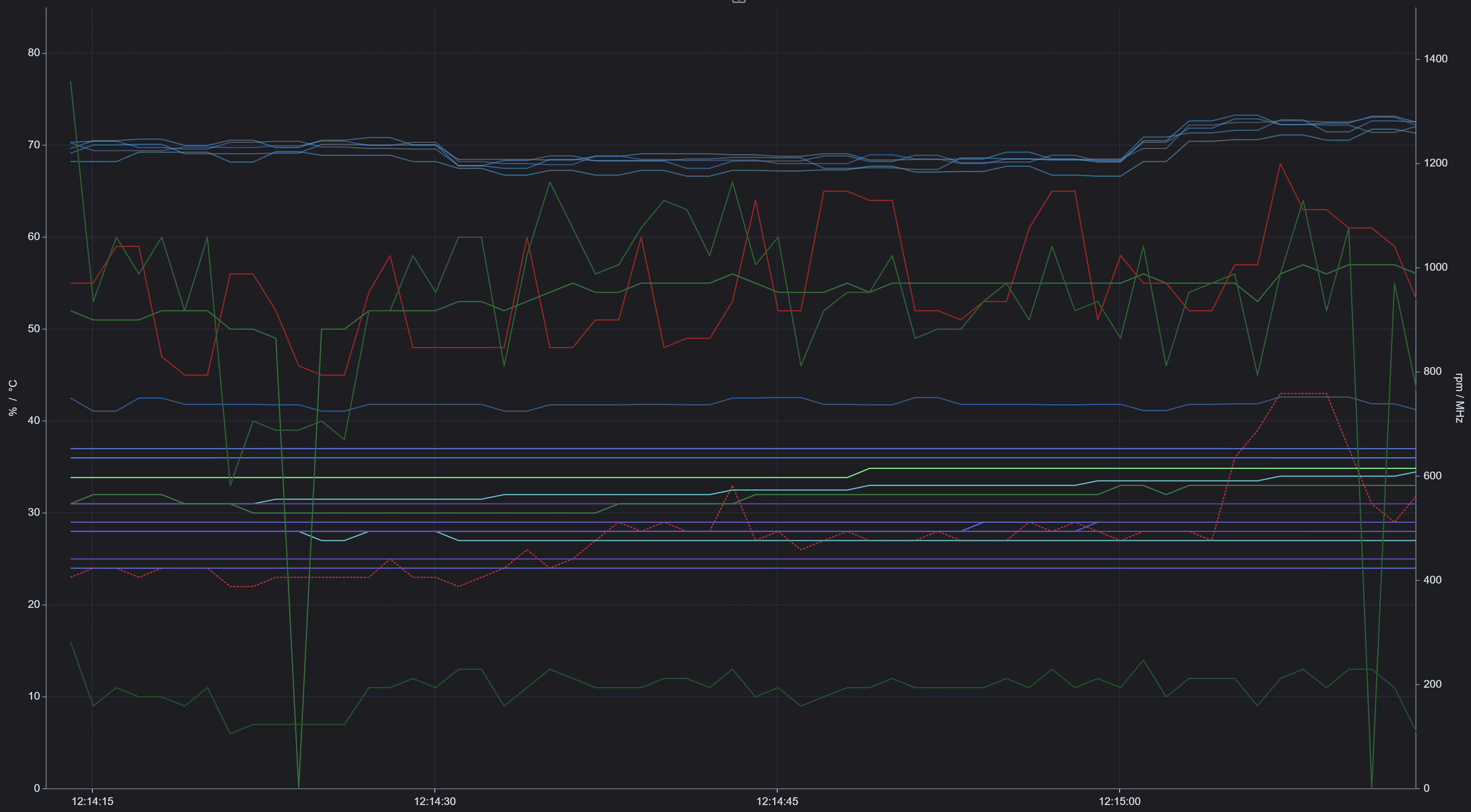

But is there a daemon for windows that can pass things back to coolercontrol? If my second system were a linux machine I understand I could pass sensor data back to a single instance can't I? Please understand... I LOVE this thing. In less than 2 days I've been able to fine tune my fans in the server that sits next to my desk so that it is nearly silent 90% of the time... and spins up correctly when it needs additional cooling. Thank You SO much. Another thing though: I've noticed that if I'm watching youtube videos they stop and stutter when I have the CoolerControl graph open... I run a little tablet monitor on my desk to show me stats and such and I've had it running since I installed this to monitor and adjust the cooling system. I generally let videos run in a window and have been suffering a lot of buffering that wasn't there before. I just noticed that if I close the Graph Tab it instantly recovers and starts up again as soon as I go back to the graph.. I just launched the graph on the tablet natively not acting as a monitor for the PC and it seems fine... So I guess it's not a server issue but rather something in Edge... Thanks Again

Figured out what I was doing wrong... I had more than one UI window open and needed to close them all and restart the Docker
