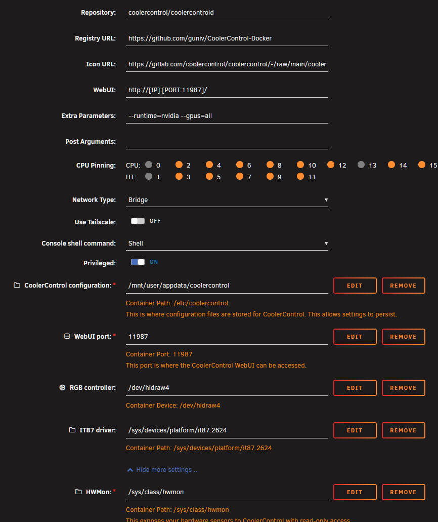

  2. Would you mind posting a screenshot of your full Docker config for the container just to double check? Like this (this is mine, will be slightly different):

  7. Did you read through the setup guide included in the container's description? You need to go mount your fans to the container. It sounds like you only have hwmon mounted at the moment, which is included in the template as read-only.

  11. Please read this guide: https://github.com/guniv/CoolerControl-Docker/blob/main/setup.md You need to run some commands to enable HDD temperature.
  12. My best guess here is that perhaps the CoolerControl container is starting before the script that enables drivetemp has a chance to start. Maybe one way around this would be to uncheck "Autostart" for the container in the Docker tab of Unraid and add this line to the drivetemp script: docker start CoolerControl So that will start the container after drivetemp has been enabled.
  13. Just chiming in here, I see the issue was identified as coming from enabling drivetemp. Another CoolerControl user had essentially the same issue and identified that in versions of Unraid earlier than 7.0.1 there was a kernel bug that caused issues with drivetemp and spun down drives: https://lore.kernel.org/linux-cve-announce/2025012131-CVE-2025-21656-b967@gregkh/T/#u I've updated the CoolerControl docs to warn users about this issue and sorry you ran into this!
  14. Yeah, if you are passing through the it8613 directory (as gone over in the setup guide) and it's still throwing this error you may need to run the container privileged.
