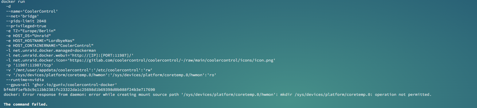

Trying to install the image fails, giving me:
docker: Error response from daemon: error while creating mount source path '/sys/devices/platform/coretemp.0/hwmon': mkdir /sys/devices/platform/coretemp.0: operation not permitted.
Trying to install as privileged, btw.
any ideas?

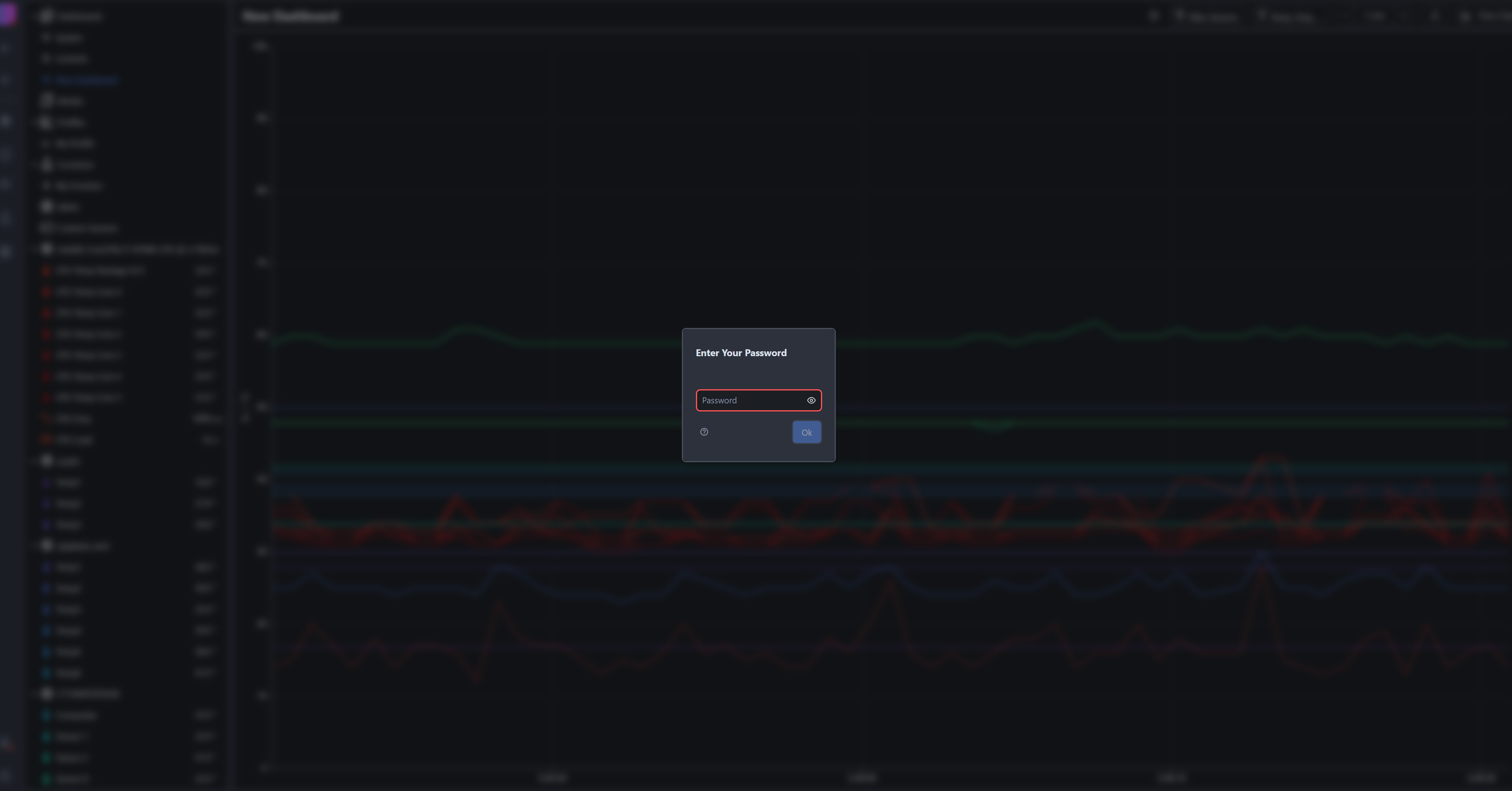

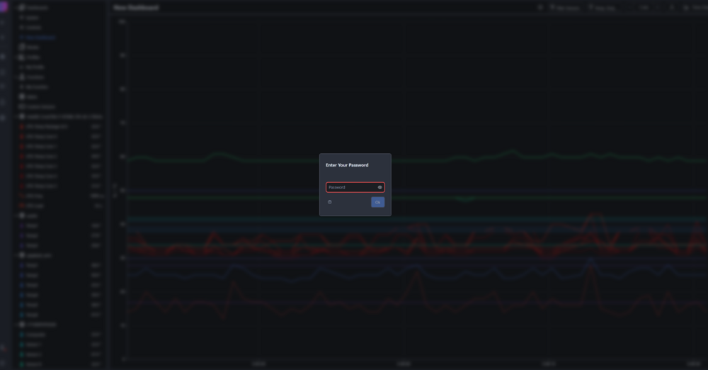

Install all fine, but as i log in, I'm asked for a password, it says use the default one. So i go on the hunt for it, half of the gitlab links end up at 404, documentation hasn't got it, install notes does not list it.
i have the same problem

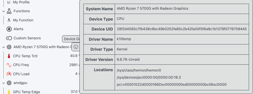

Thanks for the image. It worked for me out of the box, but it didn´t register de HDD temps (the SDDs are there). Is there any way to get them registered in the app?
I'm also getting same error relating to /sys/devices/platform/coretemp.0/hwmon - that path doesn't exist on my unraid server - is there a dependency on something else?
OK, I figured it out. I edited (more settings) container and host path (by clicking the edit button to see the expanded dialogue box) to set both to:
/sys/devices/platform/it87.2608/hwmon
I have the ITE IT87 drivers installed.
any ideas?
Can I ask what your system specs are for each of you? I'm wondering if this is an AMD vs Intel thing or something like that. I just checked on one of my systems to make sure it wasn't because a plugin I had was adding a dependency, but it still works fine after I removed a bunch of plugins that I thought might be the cause. For the record both of my systems at home are Intel based (14600k and N305).
In any case, you should be able to remove the "hwmon" mount under "Show more settings" and things should probably work after that. I'd like to get to the bottom of this if possible but I may just need to remove that volume from the default template.
As far as I know CoolerControl does not support HDD temps unfortunately. I recommend using the Dynamix Auto Fan Control plugin to assign one of your fans to cooling the HDDs. If you want this support you would have to ask the CoolerControl developers.
I'm not sure why you would be getting a password request for this as I've never encountered a login screen on CoolerControl. I did find this page in their documentation: https://docs.coolercontrol.org/wiki/access-protection.html
AMD. Will try removing the mount in the morning and will report (I'm in Europe)
That's good to know, if the other users are using AMD that would confirm my suspicions. I think what I'll have to do in this case is find the appropriate read-only mount for AMD systems and then have the users select the correct one when setting up the template.
For any of my AMD users: if you could get the container running by removing the hwmon mount and running the container privileged, and then showing me the locations listed here next to your CPU, that should help me figure out how to adjust the default template.

Thank you. I have updated the template to instead mount /sys/class/hwmon to the container which appears should work for both AMD and Intel. I have no idea how long it takes for Community Applications to use the new template, but for now anyone facing this issue can update their template manually:
Okay, I was incorrect about this! Running this on your server gives hwmon access to drive temperatures and they will show up in CoolerControl:
sudo modprobe drivetemp
So, you can set up a user script to run on first array start and CoolerControl should have no issue seeing the drive temps.

This is what I'm getting, when pressing f12 and deleting elements i can bypass this screen and start editing stuff, but every time i refresh the screen I need to fiddle around by deleting elements
I'd recommend deleting the files in the CoolerControl appdata folder that the container mounts so that it sets the config back to default and seeing if that fixes it.
