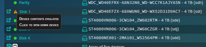

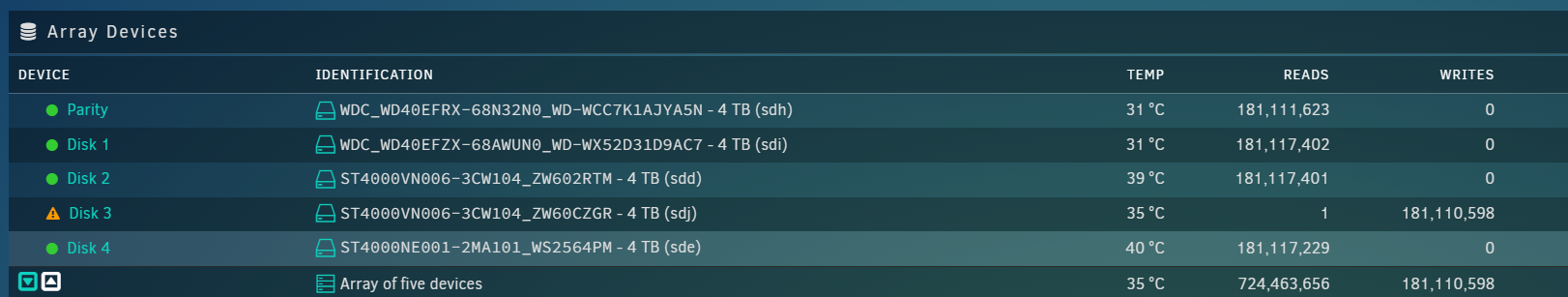

  2. hi, my disk has problem, but only UDMA CRC error count, i have replaced cable, now i want to format disk 1 and rebuild data. How can i format the disk in unraid? thanks

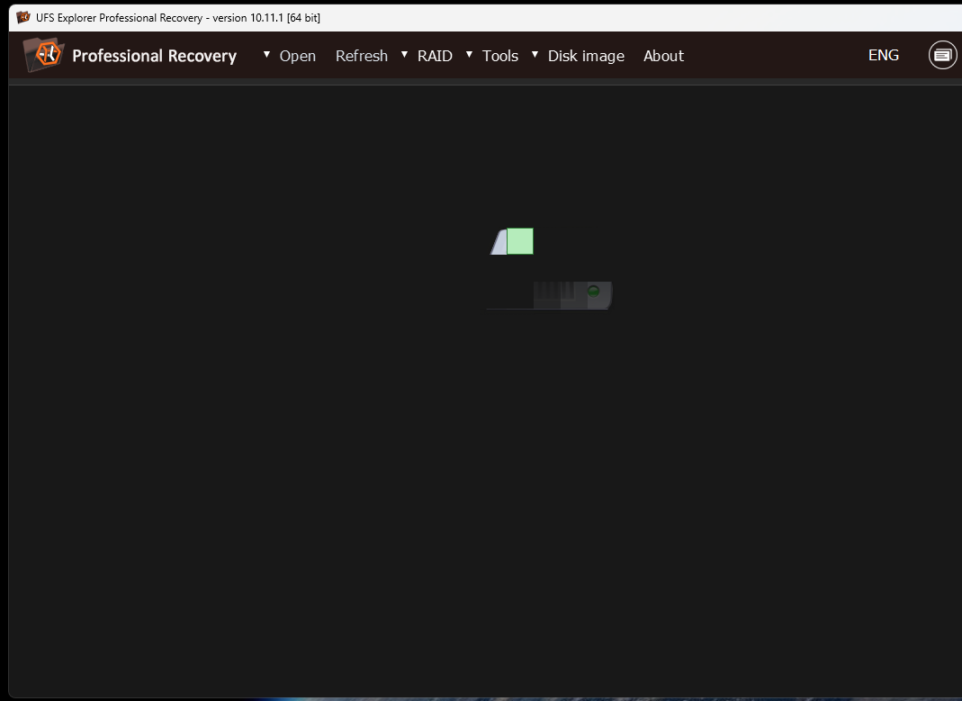

  9. yesterday i have recovered (hope all data or anyway most of all) with ufs explorer and now i'm formatting disk3. Then i'll go to copy recovered data onarray
  10. thanks, i'll try it cause ufs today is stucked on loading

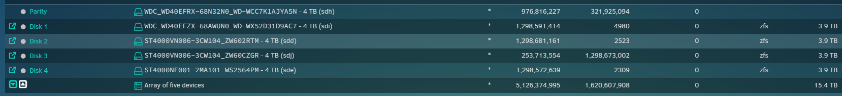

  12. it finish now and in the disk if i try scrub, i can't because it is greyed
  13. i tried but i'm still waiting an answer

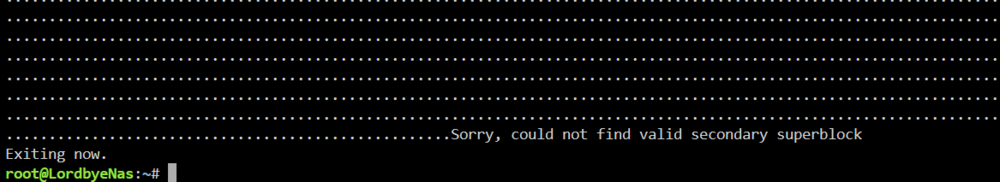

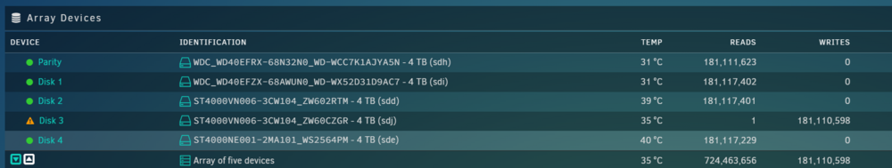

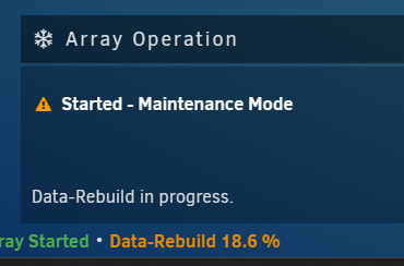

  14. ok so try to chek disk with xfs_repair /dev/sdj (disk3) or xfs_repair -v /dev/sdj
