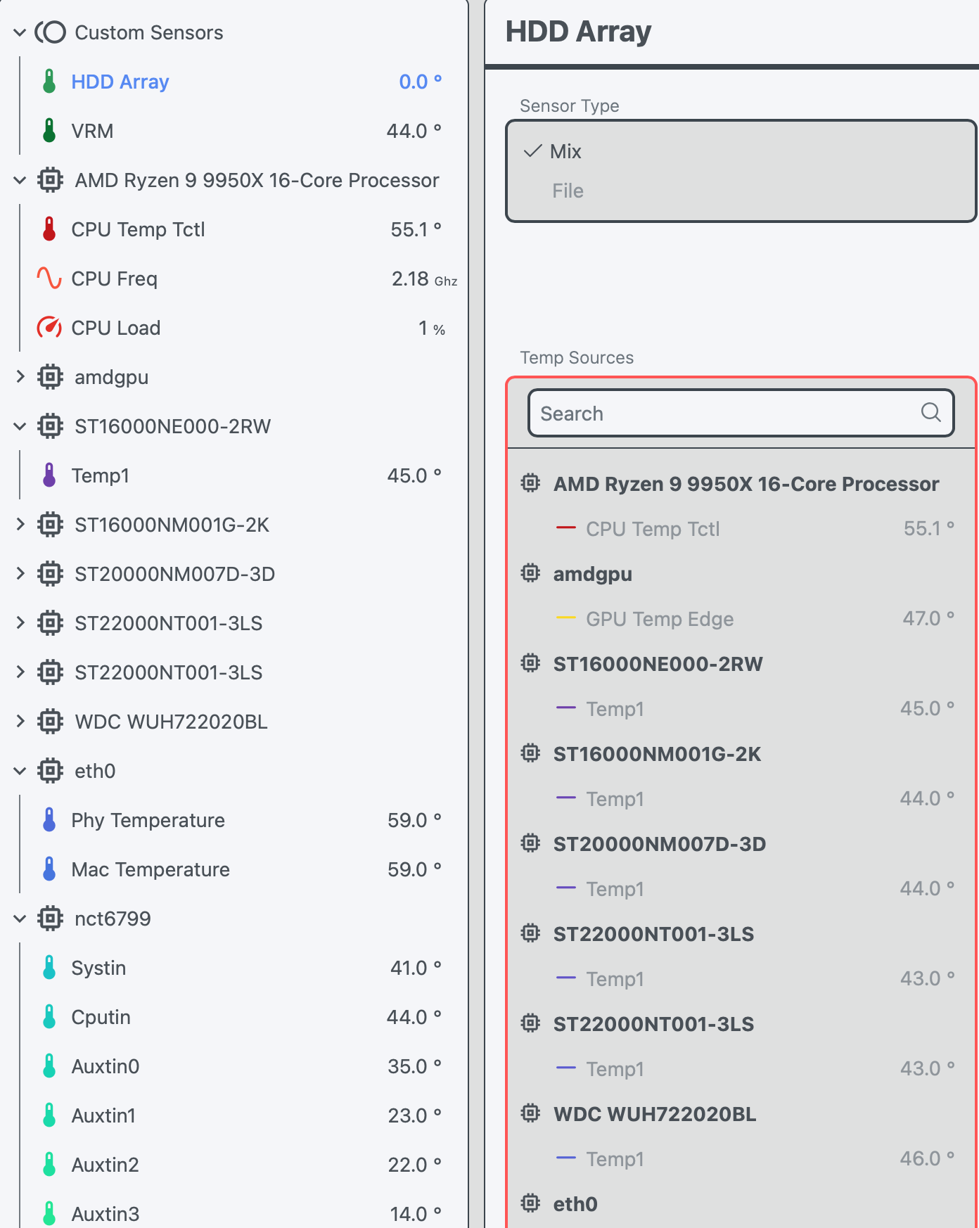

I'm facing an issue where after every Unraid host reboot, the HDD custom sensor resets to being empty. It does not reset if I just restart the container.
The VRM custom sensor does not have this problem, only the HDD ones. Something to do with the drivetemp module perhaps? Anyone has any clues?
I'm also running in privileged mode because without it, CoolerControl can't change the fan speed, only read it.

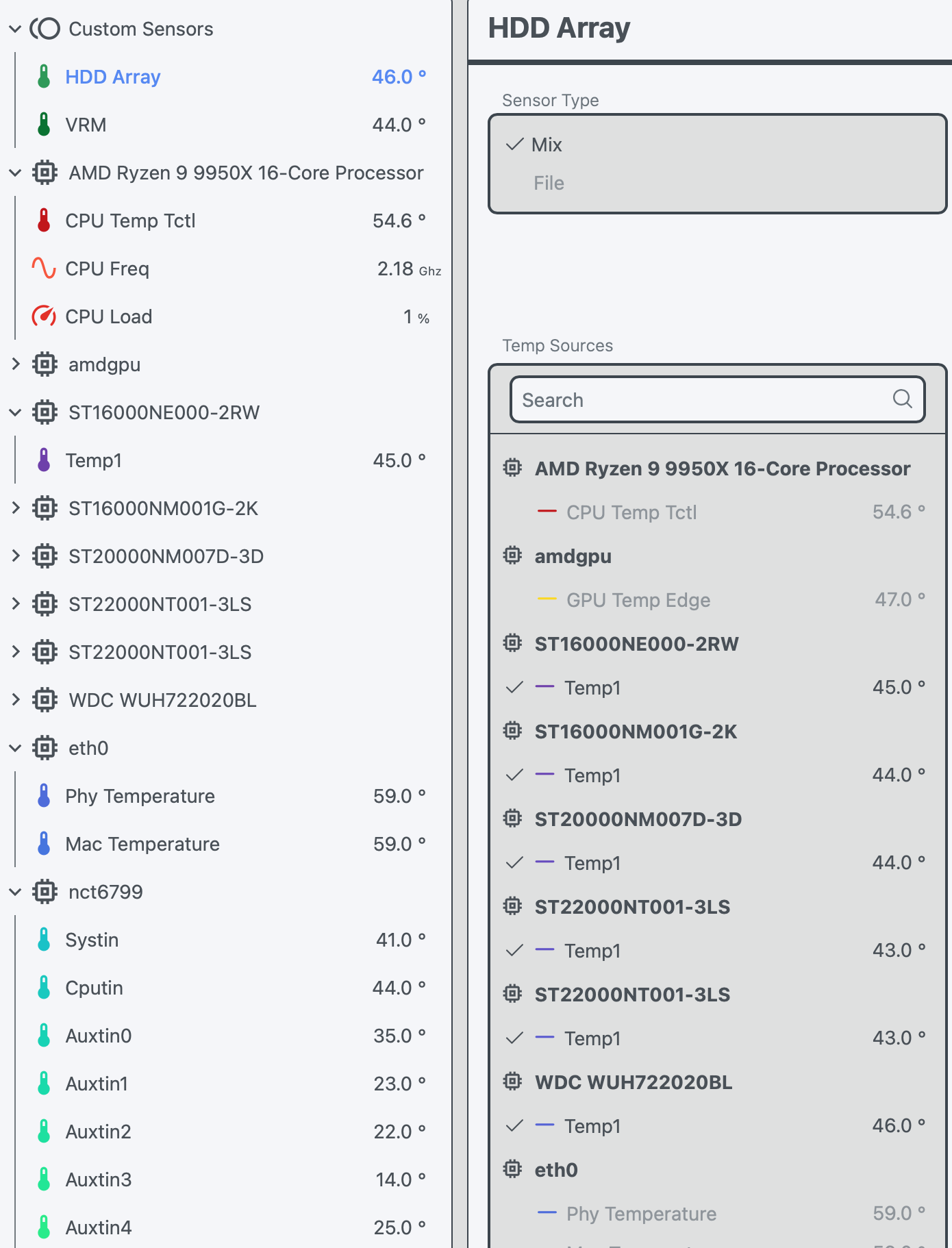

My best guess here is that perhaps the CoolerControl container is starting before the script that enables drivetemp has a chance to start.
Maybe one way around this would be to uncheck "Autostart" for the container in the Docker tab of Unraid and add this line to the drivetemp script:
docker start CoolerControl
So that will start the container after drivetemp has been enabled.
Edited by guniv

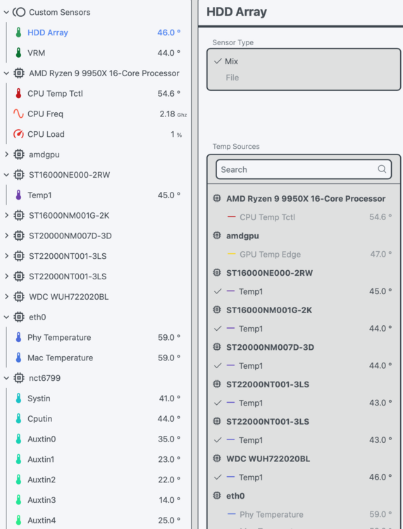

That did it. Thanks!
I added a 5 seconds sleep just to be sure.
sudo modprobe drivetemp
sleep 5
