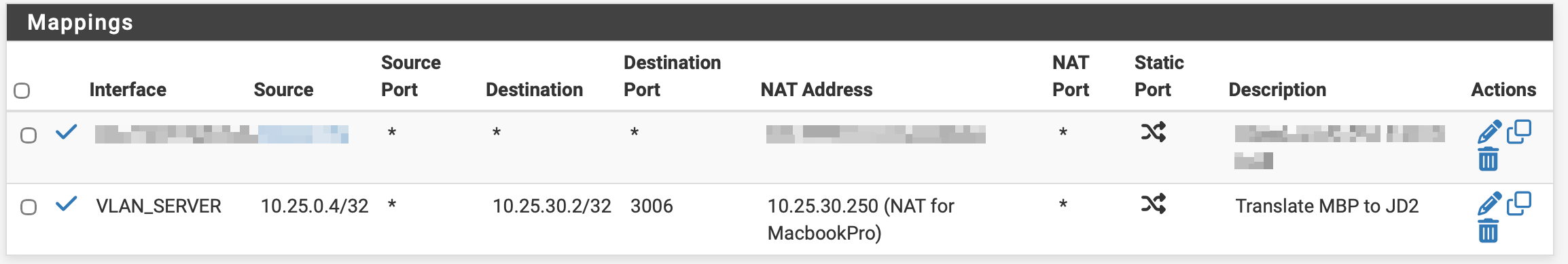

  2. I managed to access from a different VLAN by creating a NAT policy on my pfsense router. I created a virtual ip 10.25.30.250 in the subnet of the server. All traffic from my computer (10.25.0.4) going to my my server IP+port is translated to look like it is coming from 10.25.30.250.

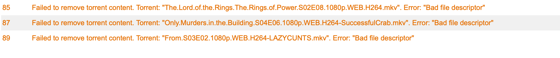

  15. yup just tested 5.0 again and that setting was the cause of the problem. Changing it to “delete files permanently”fixed it for me.
