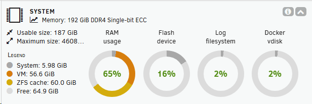

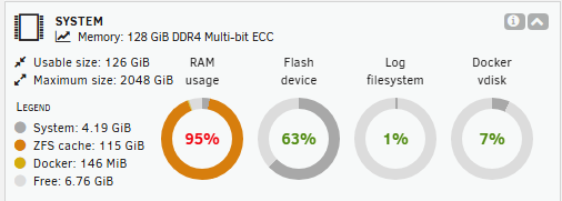

Hmm, still appears to be working as before for me, and this was after only using upgraded NVMe pools:

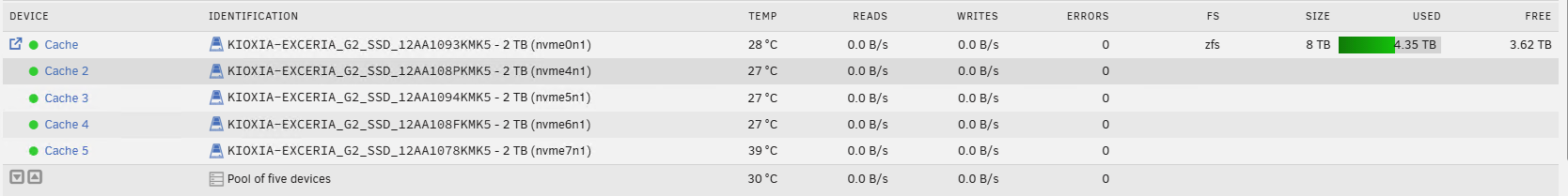

How much used storage do you have in your nvme pools?
I have another NVMe pool on this server but had only been using this one since the reboot.

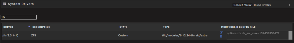

I am also seeing low arc usage in ram. currently at 5GB even though I set it to 24GB with zfs_arc_max.
It is likely caused by this https://openzfs.github.io/openzfs-docs/man/v2.3/7/zfsprops.7.html#direct
However the parameter zfs_arc_direct is not found in /sys/module/zfs/parameters/ so I can't test it.
zfs_arc_direct was introduced in OpenZFS 2.2 and is not available unless the ZFS kernel module was compiled with it
I'm running ZFS 2.3.1 userland, but the kernel module was likely built without full 2.2+ options.
Could we get the new parameter in the kernel module to test?

12 hours ago, JorgeB said:
And zero Direct IO, so likely unrelated to that, for me it's all still working as before, I've updated my 2nd main server a couipleof days ago, also upgraded all the pools, and is the same as before, this one has the ARC limited to 64G:
Could you run arcstat or
cat /proc/spl/kstat/zfs/arcstats | grep c
to check what your current target 'c' is?
2 hours ago, Sak said:
Perhaps Unraid is doing something with the auto adjusting mechanism?
Not yet, you can only set a limit in zfs.conf
Have you solved the issue? I encountered this last month but I downgraded to 7.0.1. Now with 7.1.4 available, I wonder if this issue resolved or not?
No, still consuming 4 or 5 gb, in previous versions 21.
A lot of people have been reporting this here and in reddit but officially there is no acknowledge officially by unRAID
Thank you for the response! Hope it will be resolved
supposedly it should support being set separately with the max:
options zfs zfs_arc_min=8000000000
options zfs zfs_arc_max=16000000000
for 8gb min and 16gb max for example, and some have set it to the same as the max which would theoretically fix it to full.
but might be somewhat broken in openZFS still? I'll test it next reboot, i'm seeing mixed reports on that but there are a lot of different versions and different platforms.
I've only seen this thread about this, and I'm unable to reproduce, but if you can give the necessary steps/config to do it I can try again.
I don't see this as a bug. it's been a feature of OpenZFS for a few versions now but it seems like it has either not worked in the past or the underlying behavior has changed and now more people are noticing it.
I remember when I first switched to ZFS for my cache pools in 6.12 the ARC usage sat at the allocated max permanently, but now it does scale up and down with usage.
If I fire up something busy hitting my ZFS pools with lots of repeated reads and writes the arc usage quickly maxes out and stays there, but if I let my system idle for a while it dials back down to 4-6gb out of my 16gb allocation and if I stop all containers and really drop usage to zero the arc usage pulls back to around 2gb, which is the currently set zfs_arc_min of 1/32 of system ram (I have 64gb on this system)
I think it works well, but I haven't been able to test setting zfs_arc_min which we are supposed to be able to do according to openZFS.
Looks like setting a minimum works just fine in Unraid 7.1.4
Correctly sets both the minimum and maximum and the system works within those bounds. I haven't tested setting the minimum and max the same yet as this server is my main production server and I cant reboot it willy-nilly, but I cant see why that wouldn't work according to the OpenZFS documentation and some threads on other ZFS forums
Does this show the cause of the OP's issue :
'During system boot, the file /etc/modprobe.d/zfs.conf is auto-generated to limit the ZFS ARC to 1/8 of installed memory. This can be overridden if necessary by creating a custom 'config/modprobe.d/zfs.conf' file. Future update will include ability to configure the ARC via webGUI, including auto-adjust according to memory pressure, e.g., VM start/stop.'
About | Unraid Docs
No image preview
About | Unraid Docs
Please add additional guides on how to use and configure ZFS in this subfolder
Technically it is adjustable via webgui from the Tools > System Drivers page
Thats where I've always done it.
Oh, and just a note, the meter on the dashboard is in GibiBytes, so if for example you set any of these variables to "8000000000" you will actually be setting 7.45GiB so keep that in mind if you need to see exact values in order to sleep soundly.
