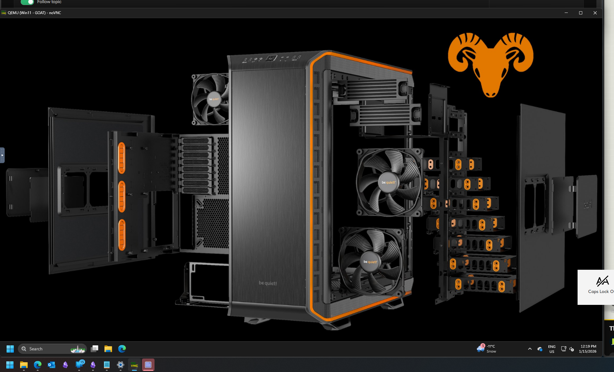

  5. Has anyone found a way to get the noVNC window to open a little cleaner? I was looking for a way to JUST get the desktop window and almost got there: %ProgramFiles(x86)%\Microsoft\Edge\Application\msedge.exe --headless="http://10.40.70.11/plugins/dynamix.vm.manager/vnc.html?v=1746576860&resize=scale&autoconnect=true&host=10.40.70.11&port=&path=/wsproxy/5701/" gives me: Which looks a lot better than with the address bar across the top. I know it's a little thing. Arbadacarba

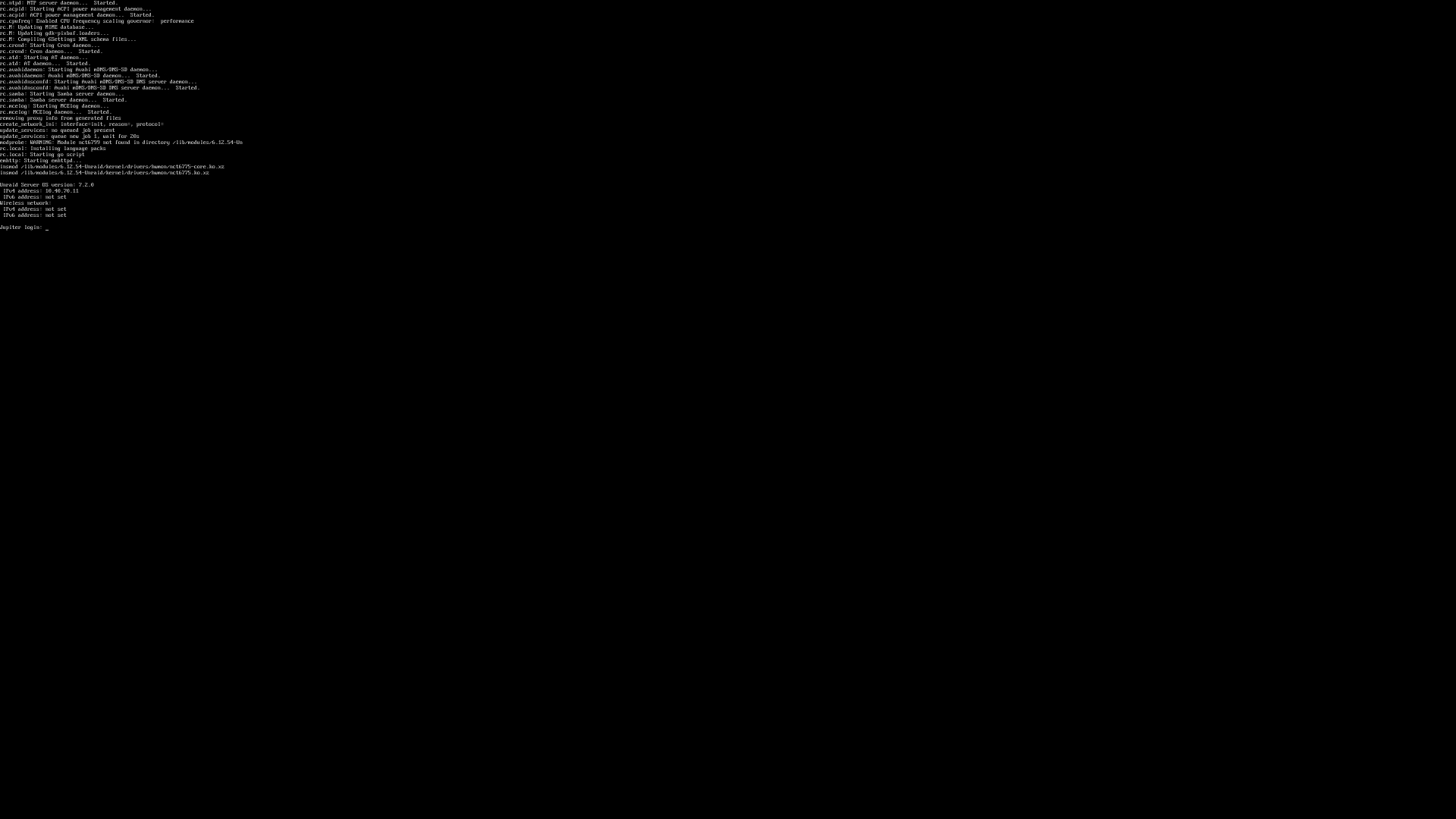

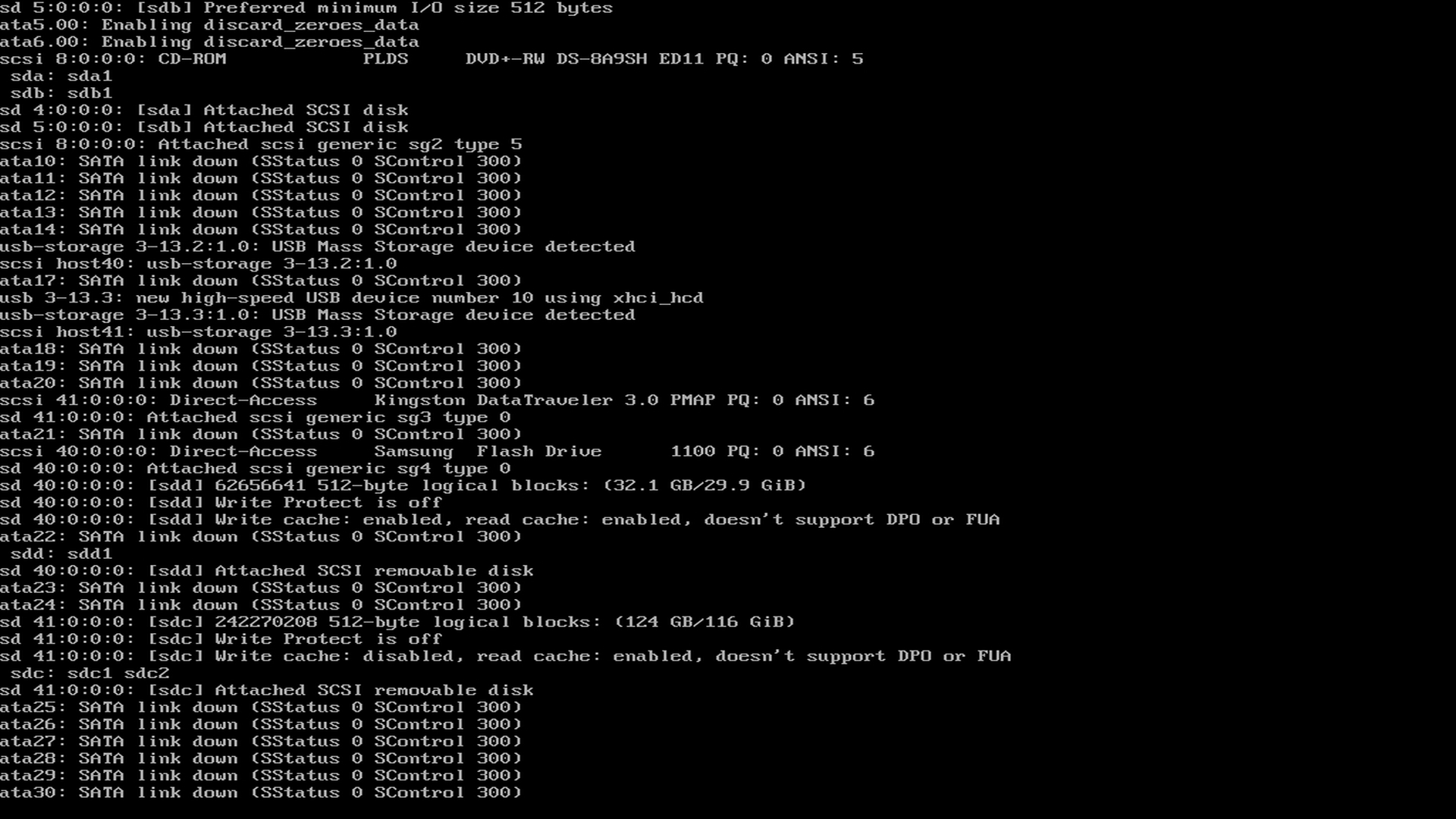

  11. I'm trying to record some examples of the boot process to try and diagnose some odd messages. Trouble is my screen jumps to a VERY high resolution and I can barely read it. It starts out fine: But then switches to: I don't even have the words to search for an answer to this. Thanks
