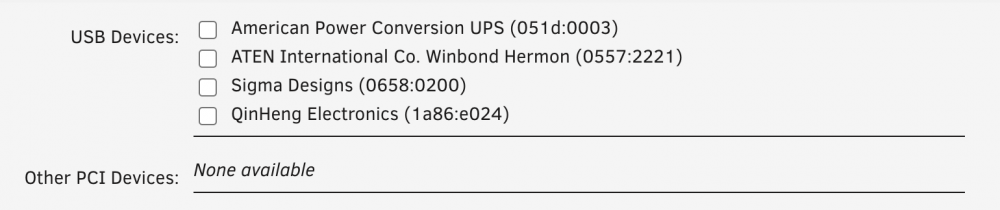

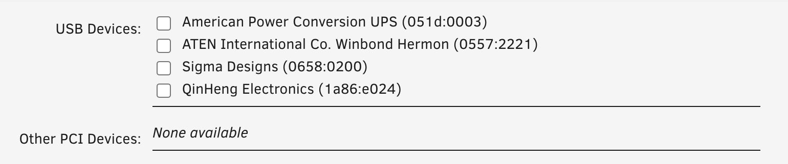

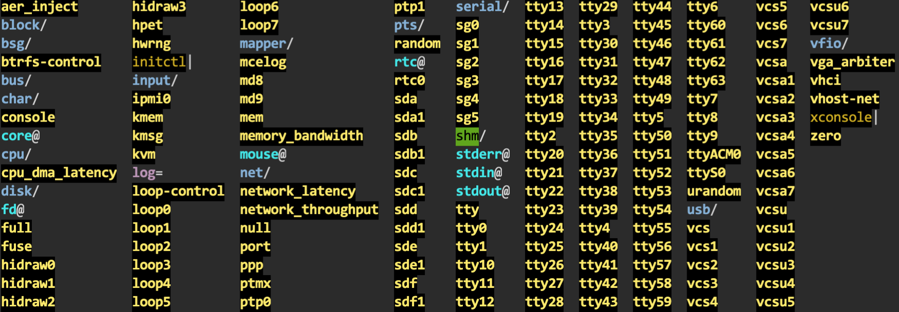

  5. Alright, so i’ve received the mini PCIe card and since I don’t have a mini slot, i’m using a mini PCIe to PCIe adapter. I have it showing up in my PCIe devices: IOMMU group 8: [1ac1:089a] 01:00.0 Non-VGA unclassified device: Global Unichip Corp. Coral Edge TPU Does not show up in VM device options: Also not seeing anything useful in /dev/: Perhaps a custom kernel with drivers? https://coral.ai/docs/m2/get-started#2a-on-linux Getting cheaper in terms of time to return and get the USB version. Anyone have ideas?
