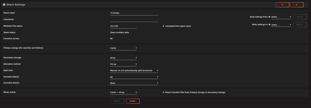

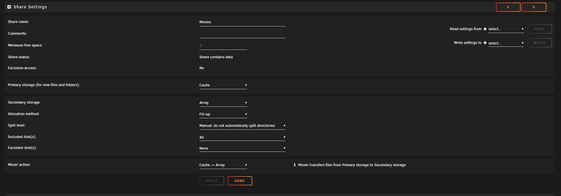

  1. Hey everyone, I updated to Unraid 6.12.10 about a month ago, and noticed last night it has not been following the settings that I have set under Shares. My current setup, which hasn't changed for a few years now, is Disk 1, with a single folder called TV Shows, with two folders underneath that called, A-D and F-M, Disk 2 also has a single folder called TV Shows, with two folders underneath that called, N-S and T-Z. Disk 3 and Disk 4 are setup much the same but they have a single folder called Movies, and then the Action, Sci-Fi, Comedy, and so on, split across the two disks. I then have two Shares, TV Shows and Movies, with the below settings. Since the update to 6.12.10 when I write to the Shares ( I use FTP if that is important), it will create the N-S and T-Z folders on disk 1, which has more free space, even though the Share has "Allocation method" set to "Fill Up" and "Split Level" set to "Manual: do not automatically split directories". It is also doing it with the Movie shares too. Is this a bug, or am I missing something here? Any help would be appreciated. Thanks, Dave
