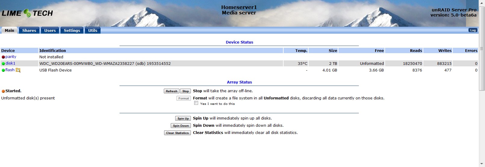

I have an unraid server 5.0 server, Beta 6a.
I had installed 5 two TB disks as disk1, disk2, disk3, disk4 and disk5. No parity disk.
Disk 5 had no data, so I wanted this to become a parity disk.
I stopped the server, Cleared configuration and set the server up with parity disk and four data disks.
But instead of setting disk 5 as parity i managed to set disk 1 as new parity.
The parity sync started, and I found out what was wrong after about 10 seconds.
I corrected the error, but now my disk1 shows as unformatted.
Is there anyway I can salvage some of my data? I had all my photos on this disk.

The job is now done. How do I access the data?
I tried to set only disk1 active in UNRAID. Bu the disk is still "unformatted".
did also try to mount the disk with: mount /dev/sdb /mnt/disk1
This gave me an error saying:
mount: mount point /mnt/disk1 does not exist

Did you reboot?  I think I had to reboot before I saw anything if I remember right.
I have rebooted now, but the disk still shows as unformatted.
