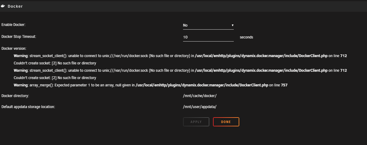

April 17, 20233 yr Hi All I'm seeing a weird error in Docker Settings (6.11.5) If the Docker service is stopped, but the array is still up then I get this error. If I stop the array, then go back to docker settings, then all behaves fine.. Irritatingly, none of the other pages which need Docker to be stopped recognise it as being stopped while this error is in place. So i have to stop the array to change these settings (it's network this morning....) I've checked the DockerClient.php file, and it's consistent with what was the current commit in GitHub as of the 6.11.5 release date, so I'm content that i've not borked anything at the UI level. Any ideas on where to look next? Is there an extra unnecesary extra slash in "unix:///var/run/docker.sock" - and if so is that being retrieved from somewhere? Edited April 17, 20233 yr by Meles Meles
April 17, 20233 yr The system for some reason thinks that the docker service is still enabled, even though it doesn't appear to be. Reboot, start the array, start docker, wait a bit, stop docker and see if the error is still there and then post your diagnostics
