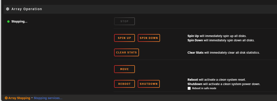

I stopped the array and have a stop watch going. Just passed 5 minutes, will update when it finishes.

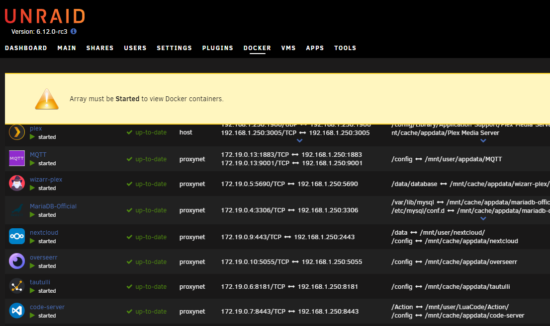

It's now been 20 minutes. Docker tab is confused about if docker is running or not. All of my dockers appear to be access able and the UI works under the warning. Not a single Docker was stopped. Same with VMs. I'm not really convinced that clicking stop array did anything other than change the status at the bottom of the window
tower-diagnostics-20230420-1242.zip
After some quick testing, I believe I found the problem. I had changed the  "Upon host shutdown" setting to Hibernate and my Home Assistant VM does not respond to a Hibernate command . Based on the help tip for the "VM shutdown time-out" setting Unraid should attempt to shutdown the VM but is not, preventing the array from stopping. Changed that setting back to shutdown and the array now stops in just over a minute as expected.
