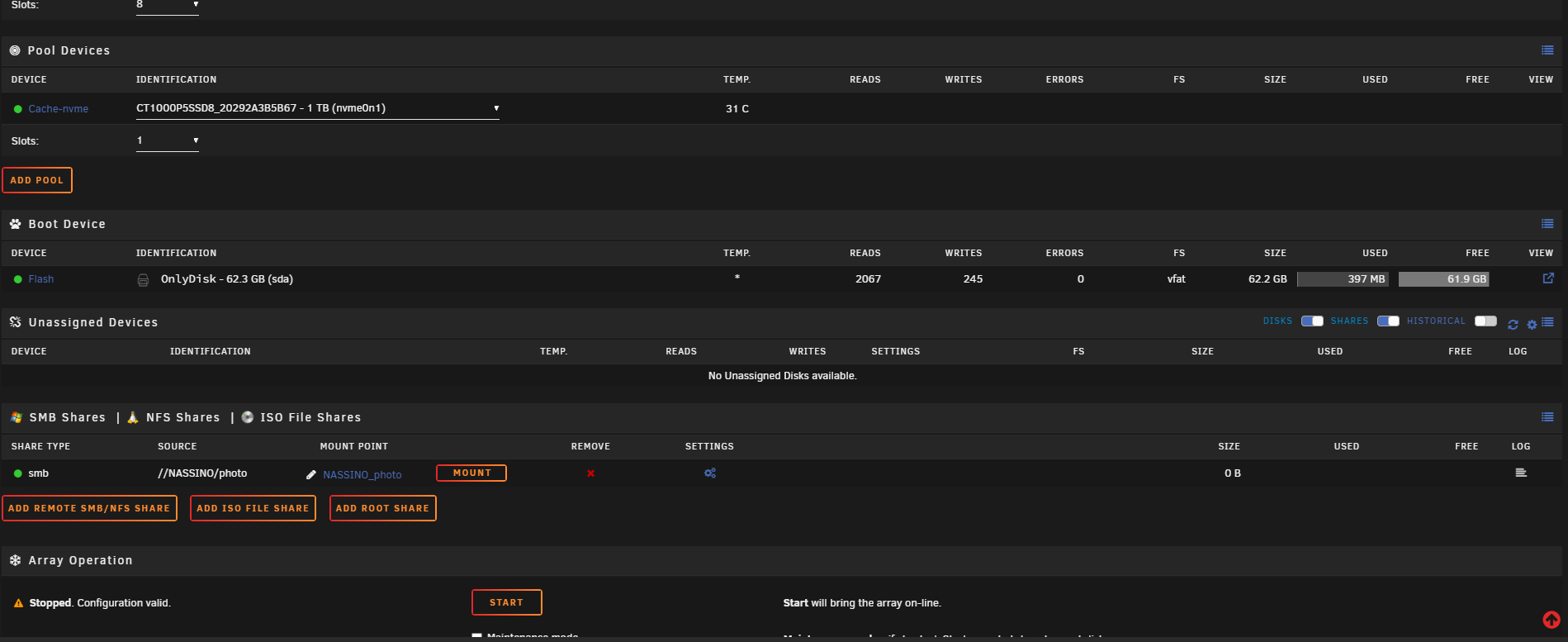

so I'm using unRaid in tryal mode just to test it... only I can't make the system see the fourth hardisk.
Now, I personally don't think it's a problem with the sata controller I'm using.

Not seeing any trouble detecting the missing disk, is it detected if you connect it to the onboard SATA instead?
uhm... nope dont work

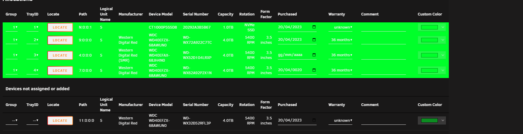

but is very strange because... Disk Location can see the disk
but no in the main page

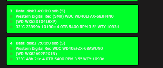

and for some reasons... this 2 have the same id "sdb"
the smr disk is the new disk I'm trying to add
