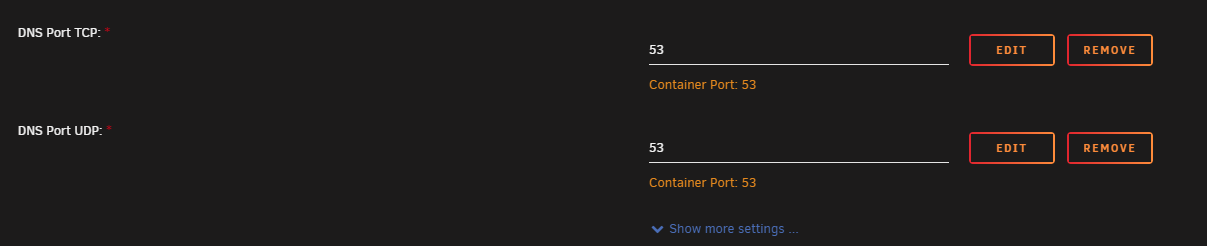

May 2, 20233 yr never mind, today the container starts normal, but could you make it so that the port mappings are shown in the overview?
May 2, 20233 yr Author 2 hours ago, chiwou said: never mind, today the container starts normal, but could you make it so that the port mappings are shown in the overview? what do you mean ?
