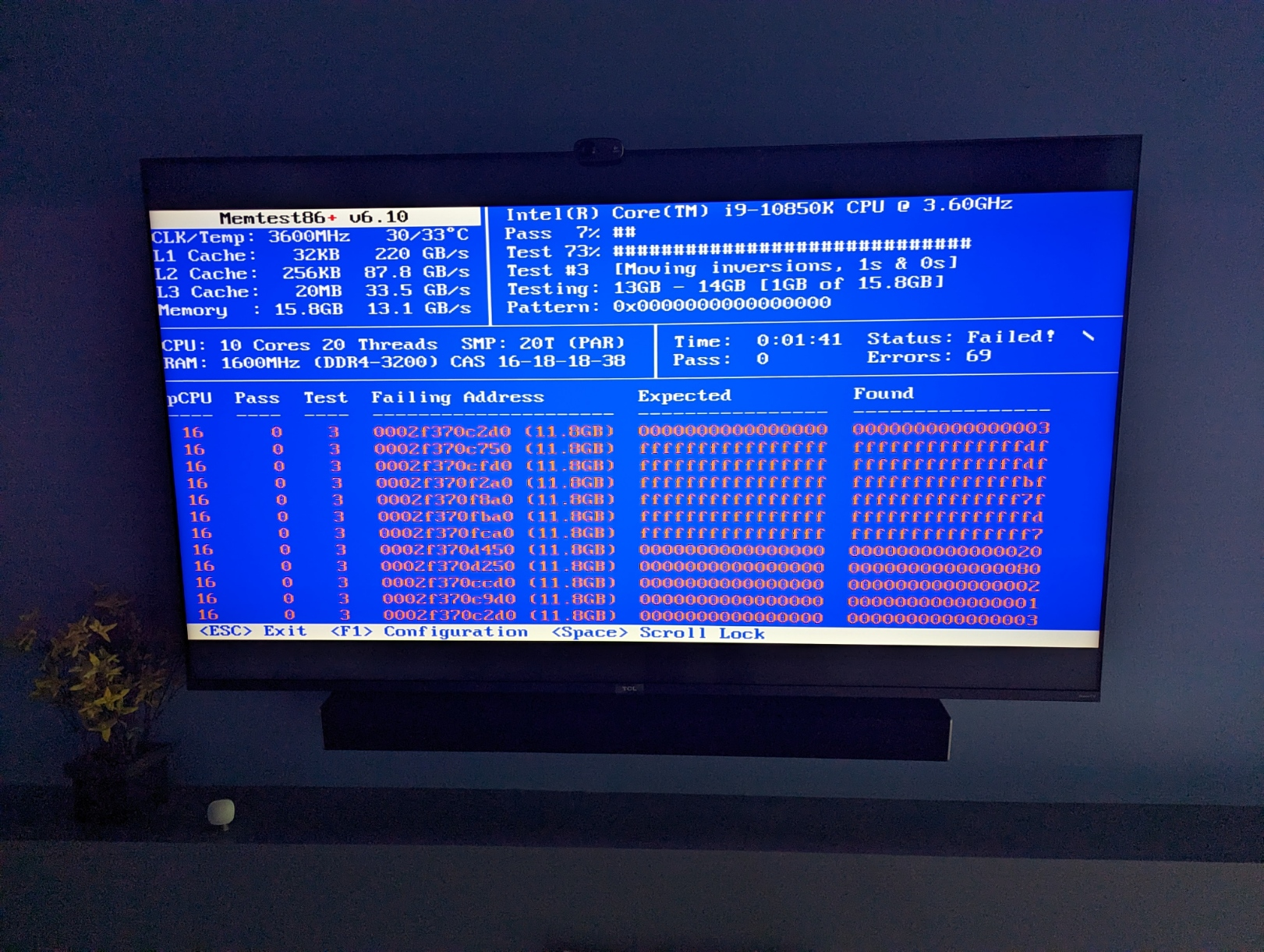

Memtest86+ lit up like a christmas tree.  Moved the two sticks around and tried scanning each stick individually and I seem to have narrowed it down to one of the specific sticks of memory.  Currently running the server on 16GB (shut down my windows VM to give some breathing room).  I have a feeling GSkill is going to want me to send in both sticks for RMA/Warranty, but I don't think I can survive having no server for that long.  I hate to throw more money at GSkill till I find out how the warranty work goes, but the best option is probably to buy an identical pair ($65) and then once I get the RMA stuff back, I can up the server to 64GB.
Hopefully this is fully caused by faulty memory.  It's been a LONG time since I've had a stick of memory go bad on me this far into it's life without some kind of outside influence.  This PC was built in August of 21, and other than a corrupted cache drive, it was pretty much flawless the first year.  Issues seem to be accelerating, but that might be because I've been putting more demand on the RAM as of late.
