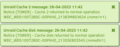

Yaaaasssss.  Thank you!
Scrubbing now.  Will follow up with results and diags in a bit for refrence
