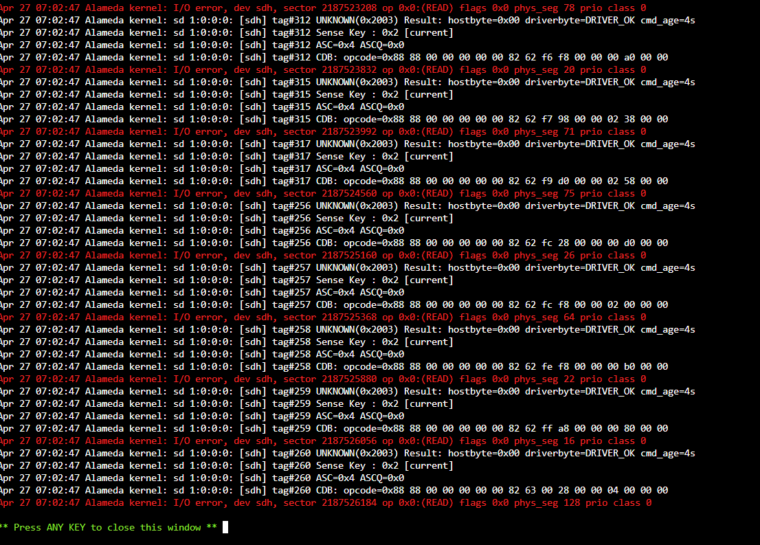

On my server i had a lot of old smaller drives and a few bigger newer drives. I started getting a problem where a disk(not always the same) would get exactly 2048 errors and the disk would disable. Running extended SMART check would show nothing wrong with the disk and it could re-build like normal. The fault would appear, i think, when the mover was running or during Parity-check.

Parity just rebuilt over the last couple of days and everything looked sweet until this morning at 0700, when the mover started running. One of the new disks, that hasnt had a fault before, posted 2048 errors again and was disabled.
Why the exact same number of errors each time? Why no problem at parity sync or normal operation but only when mover started working?
Am i looking at a bad SATA cable?
Please see the logs attached.

Is it always one of the Seagate disks connected to the LSI HBA?

Hi Jorge,
I am not really sure. It has happened 3-4 times. The last two times was on the 12TB Seagate drive, before i removed all the old drives. I dont recall which drive it was before that(if it even happened. i should have kept a better eye on what has been going on). Under all circumstances it is very likely that it has been drives connected to the LSI HBA board each time. It certainly was this time.

I would recommend connecting those 12TB Seagate to the onboard SATA, swap with other model disks if needed, there have been some issues with LSI SAS2 HBAs and high capacity Seagate disks.
