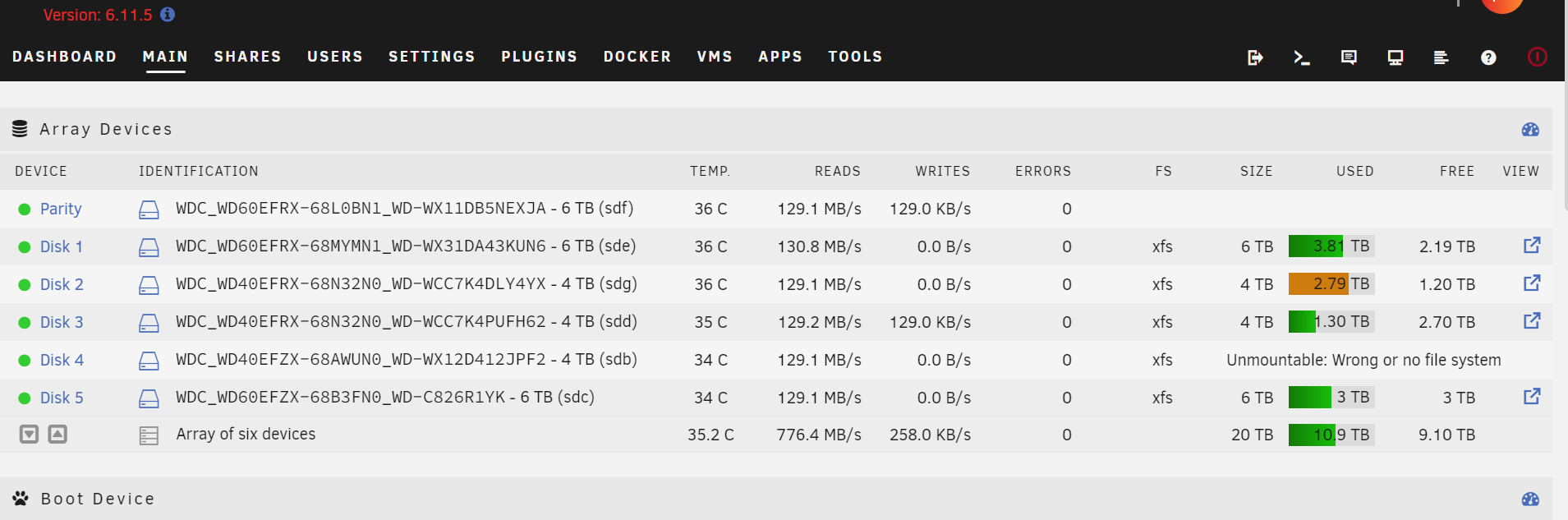

UNMOUNTABLE: NO FILE SYSTEM
I lost disk 3 & 4 rebooted and both came back online but 4 showed no file system, stopped array started in maintenance mode, removed drive 4 and readded and started array, unraid completed a rebuild of the drive but it still shows unmountable
i have attached diagnostics and a screenshow of the home of the UI
how can i get it back without formatting?

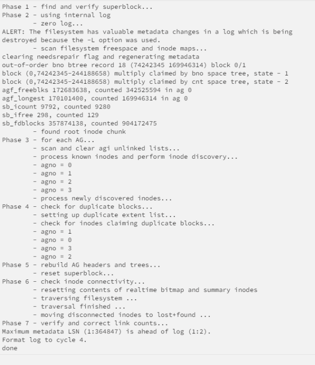

I let the parity check finish because it was over 60%, ran the check -n then -L, UI said it could take hours, 5 minutes later it completed, restarted array and disk 4 back online and mounted
im guessing it must have only had a small corruption?
Edited by Mattlevant
The check is normally very fast for xfs format drives so minutes sounds correct.    You should now look to see if you have a lost+found folder on the drive which is where the repair process would put any files for which it could not find the name.
