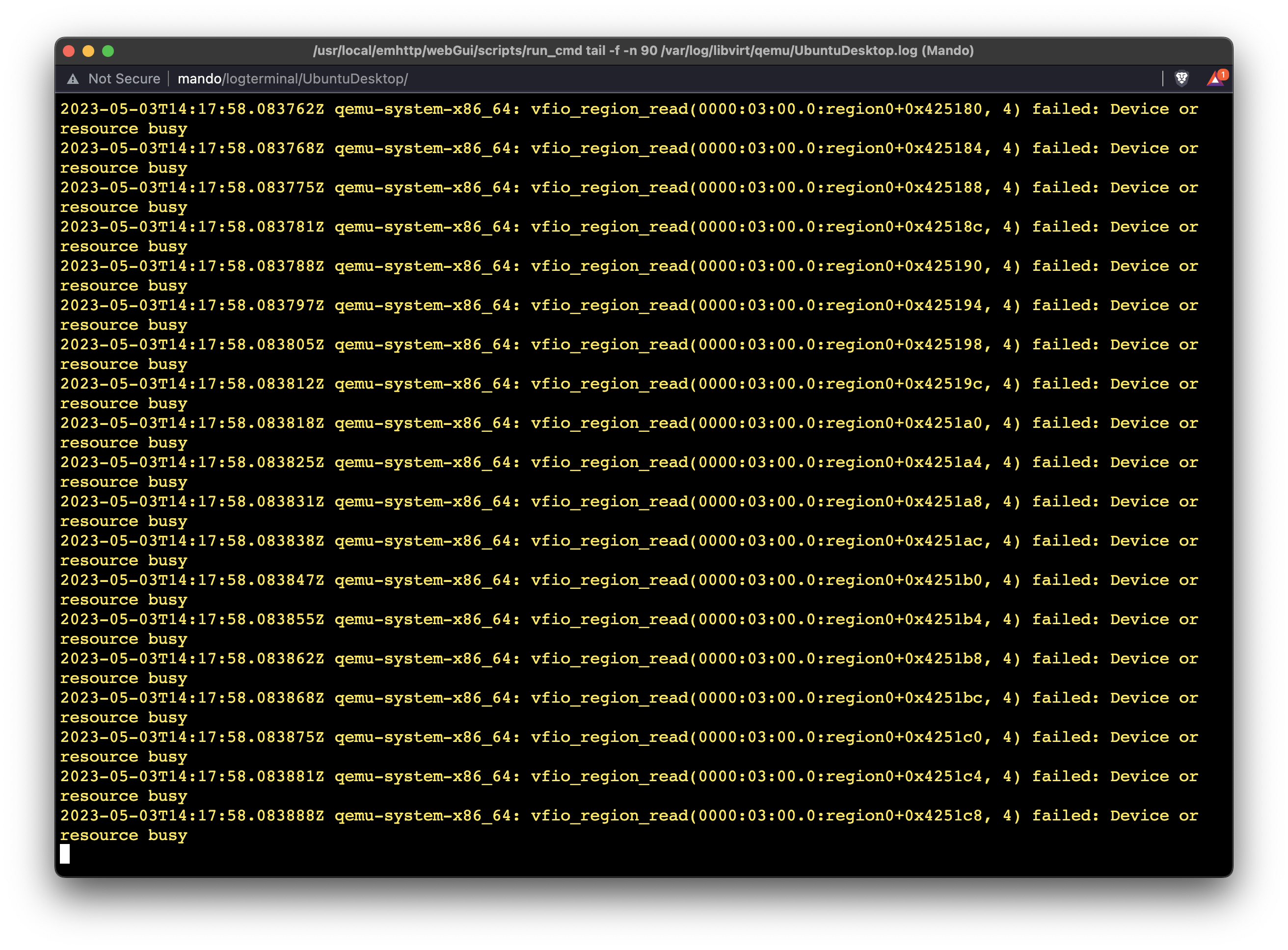

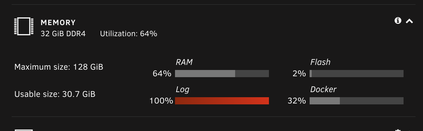

  2. I have been able to get an Ubuntu VM up, but I am having some issues. Specifically, when the VM runs, I get error messages stating that my Log file is at 100% (see the attached screenshots). I can see through the Log file that the same error is spamming the system, but I don't know how to parse the log to understand it. How do I fix this spamming problem?

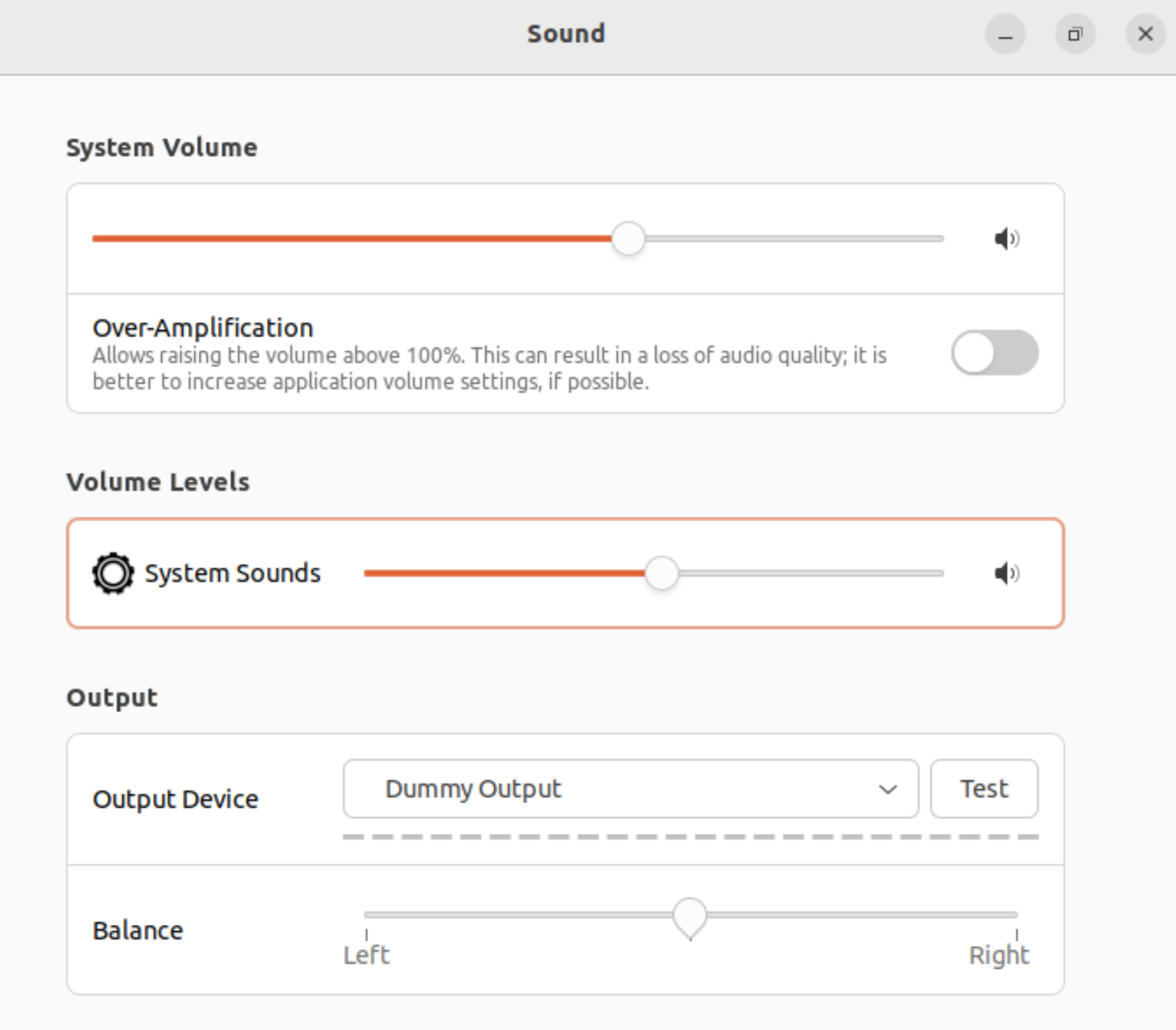

  3. As stated in #2, I have been able to install a desktop version of Ubuntu in a VM. My Radeon graphics card is passed through to this VM and is mostly working well. However, I am unable to pass through any sound signal to the VM. No matter what I try, Ubuntu's Output Device is "Dummy Output" and no sound comes out of the VM. How do I get the audio working in this VM?
