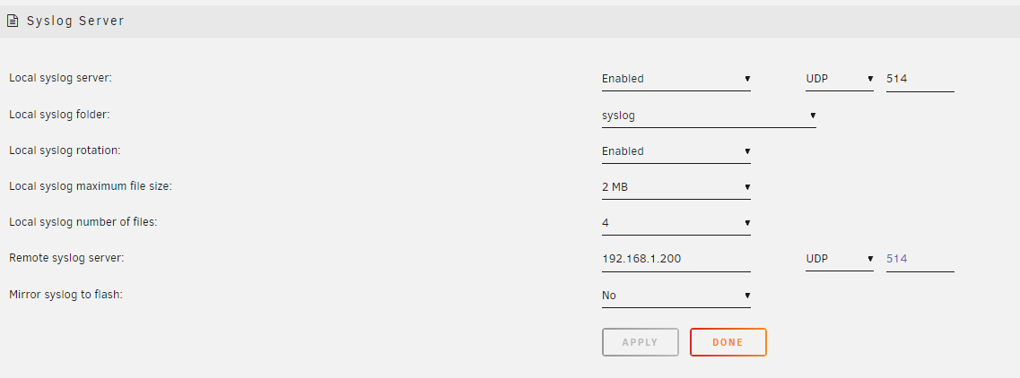

Instead, you can enable Syslog Server to write a persistent log.  Go to Settings -> Syslog Server.  the most basic configuration just writes a rotating syslog file to a share.  I have mine set up to write to a cache-only share like so:
*edit* For temporary debug, you can also enable it to "Mirror syslog to flash".  That's fine for the short term but will cause unnecessary flash drive wear over time.
