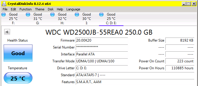

Thermal shock and excessive heat are what usually kills components.  My oldest working hard drive (shown below) has been running continuously for over 12 years.
