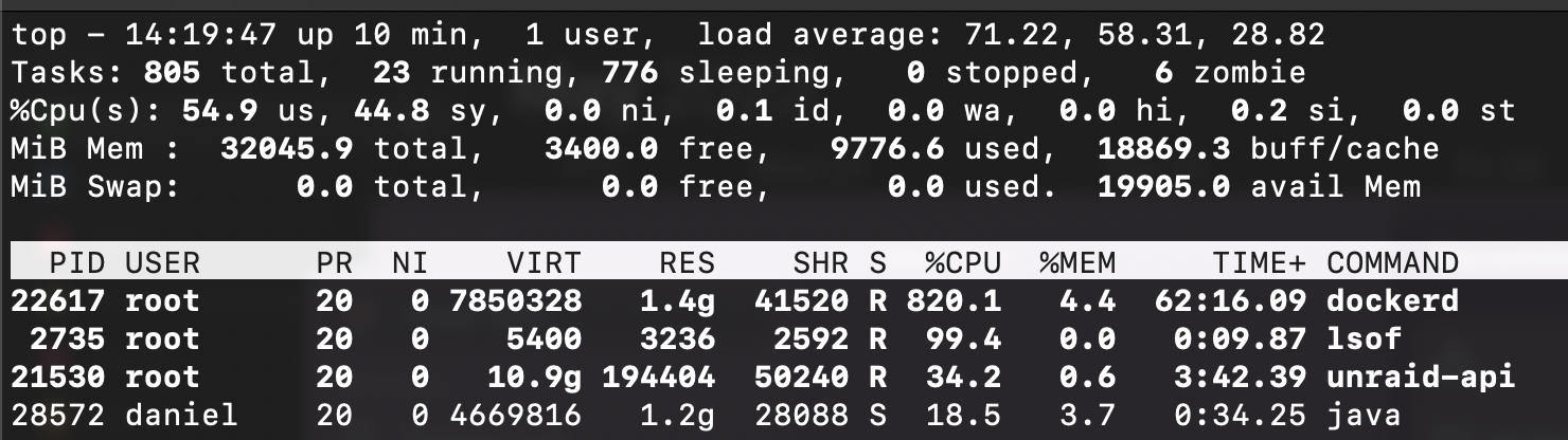

I'm getting huge CPU usage from the docker service causing my system/webgui to lock up.
It started right in the middle of normal operation (was renaming some files in Sonarr I think). I cannot attribute it to any specific container as the problem persists even with all containers off. I've tried turning them on/off one at a time but no obvious culprit. If I disable the Docker service entirely though, it seems to go away. The only other change I have made recently is increasing the size of the docker image from 64gb to 96gb.
Top is showing Dockerd using around 600%.
A couple of orphaned docker images were created around this time but not exactly sure when. I am also noticing irregularly high reads in my cache pool (the one with my appdata and docker img). Is this corruption?

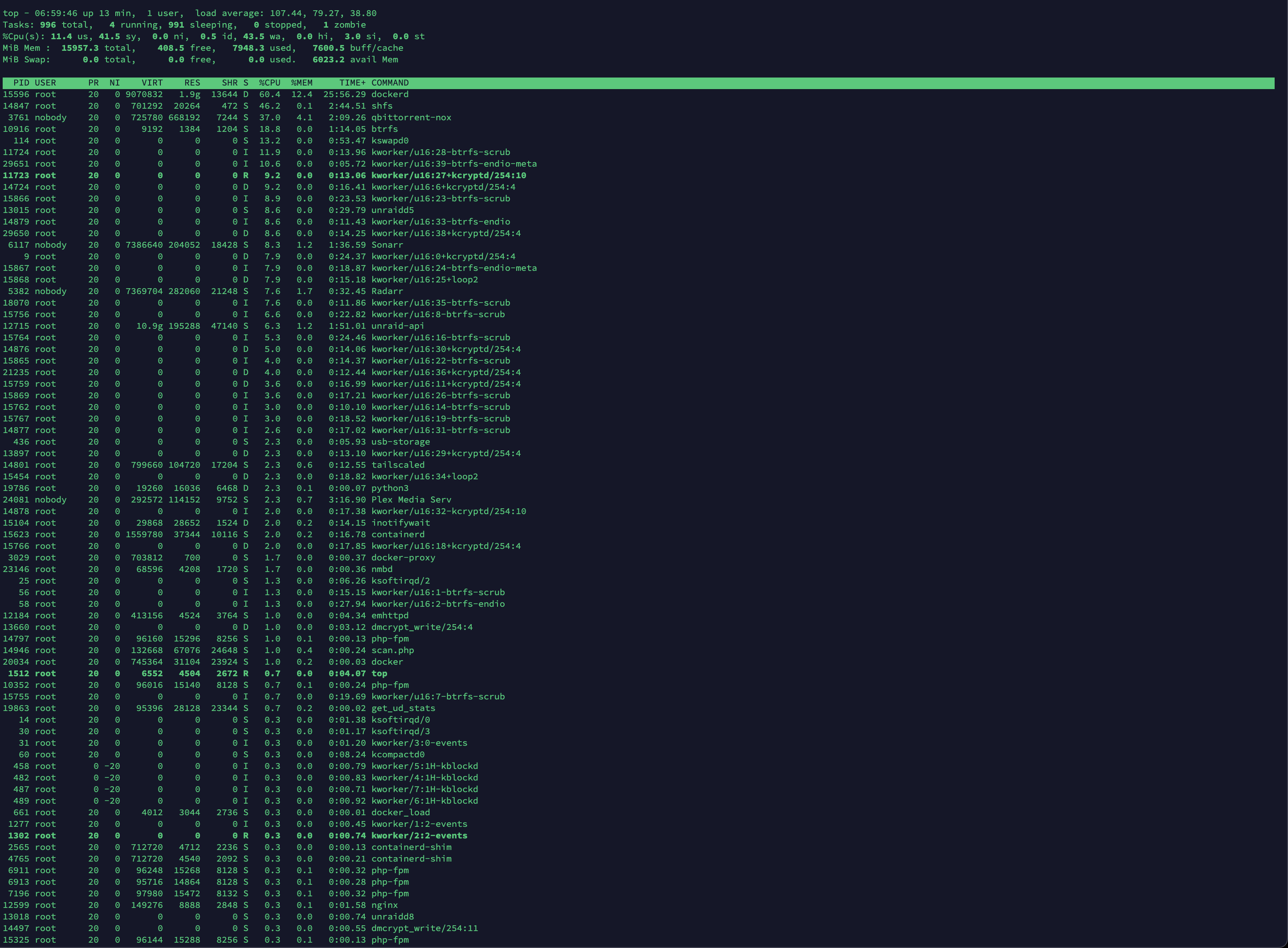

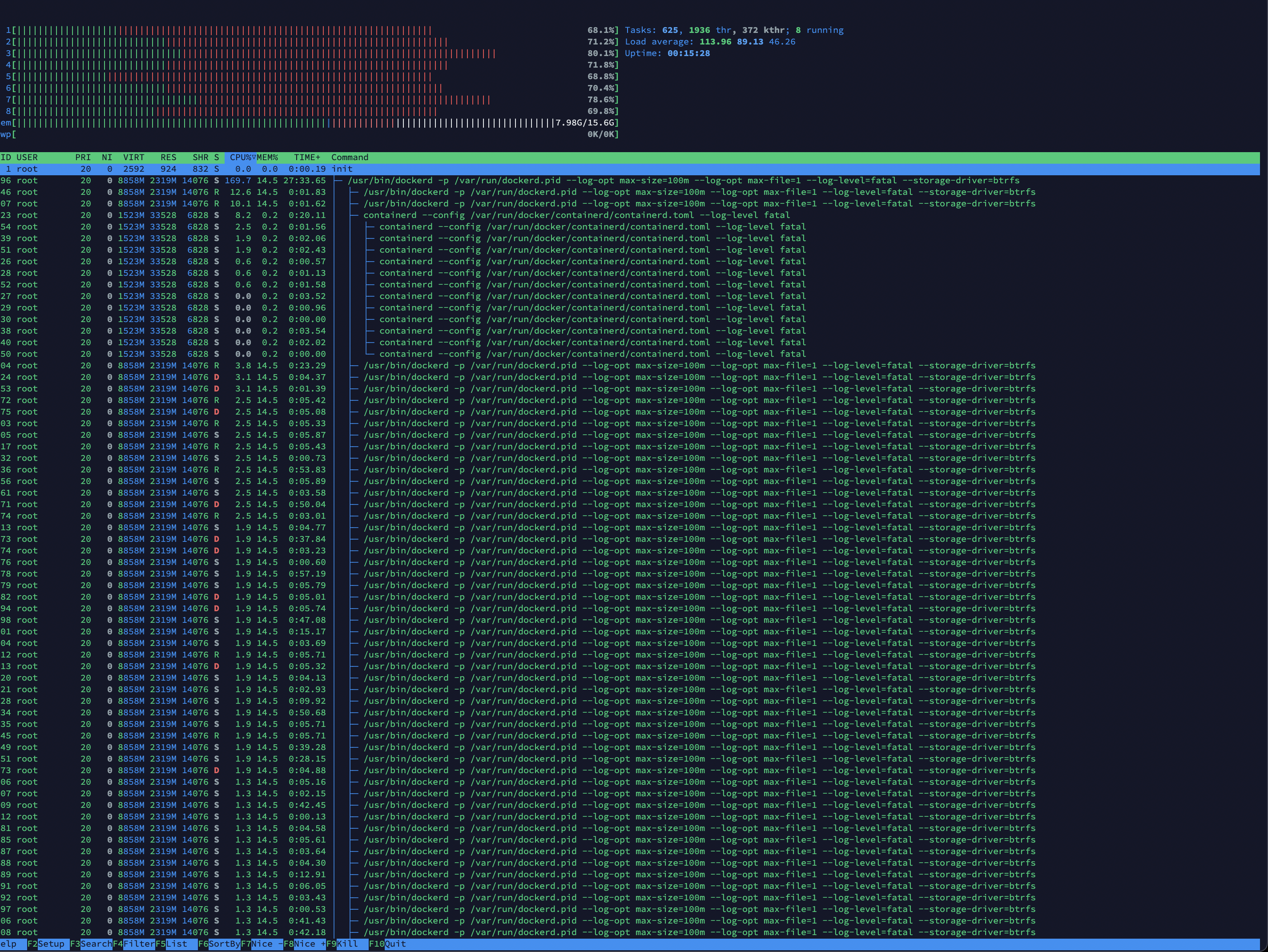

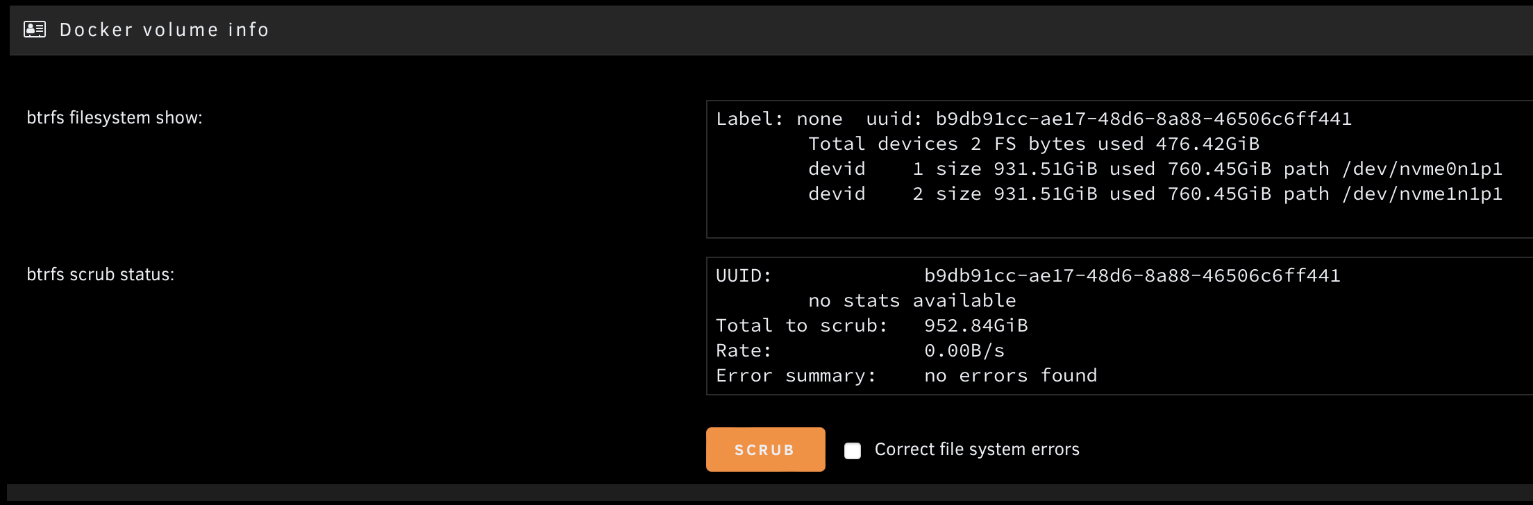

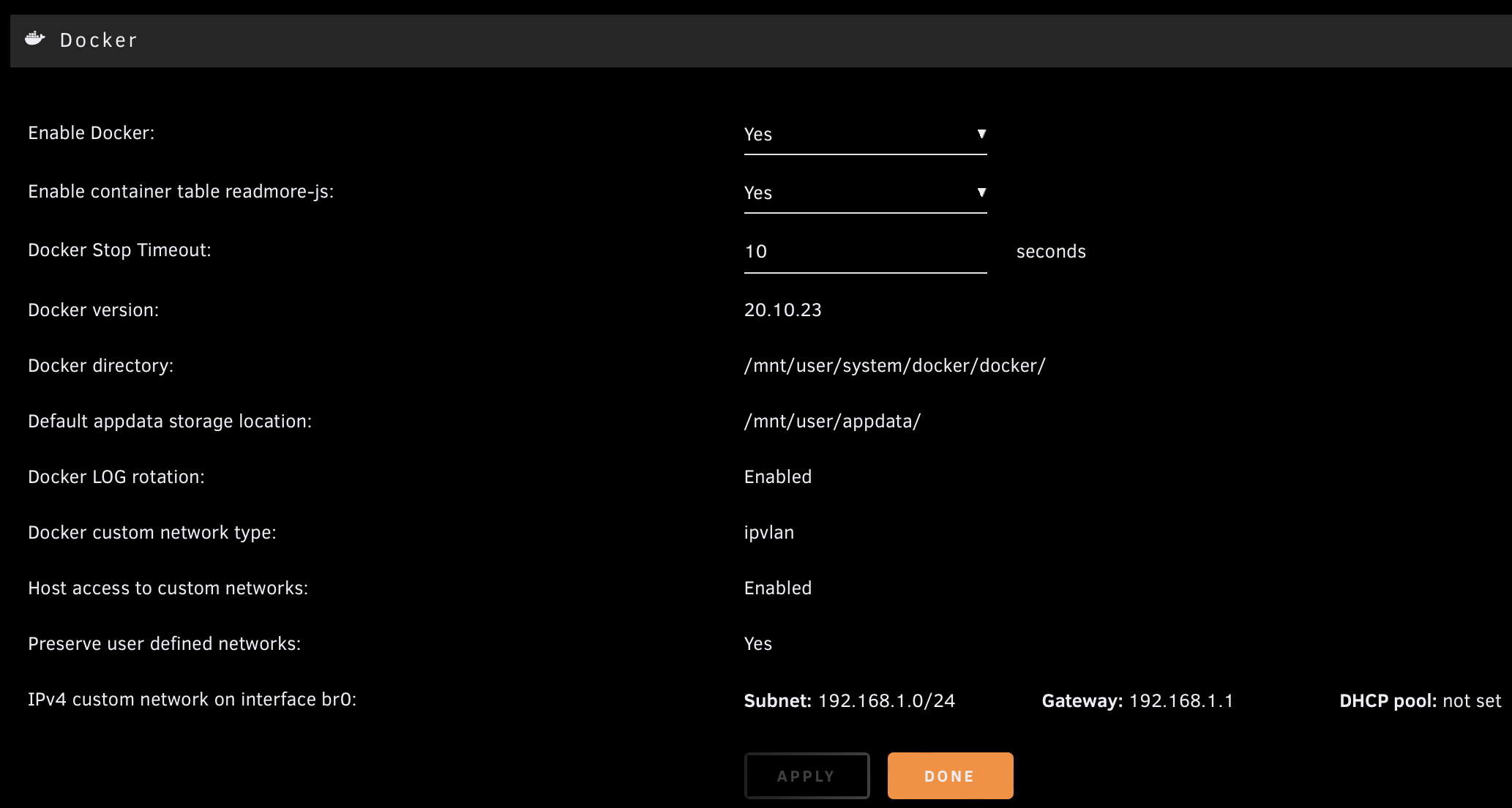

I have the same or at least a similar problem. I am on 6.12.0-rc5. I am using a directory instead of a docker image, which is placed on the cache pool (2 nvme drives, raid 1, btrfs). The cache pool is not full and not corrupt. Any suggestions? Tried restarting and stopping individual containers, no change. Please find screenshots and diagnostics attached.
Best
Daniel

A scrub won't return anything specifically in regards to Docker Image corruption. Just overall corruption I believe.
