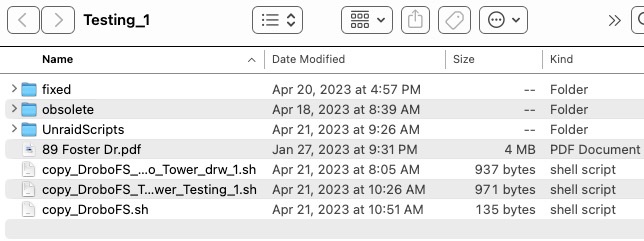

So I am moving files from Drobo Servers to Unraid.
I wrote a script earlier that created a directory off of root and mounted an SMB share there.
Then used rsync to copy files from that directory to the Share location in Unraid.  It worked correctly, but was a little clumsy.
Then trying to clean things up, I wrote this:

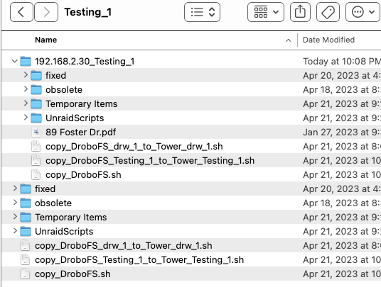

The source is the first picture and the second picture is the destination.
The destination has picked up a folder with the ip addr and share name.
See how it is doubled up?
What am I doing wrong?

On 5/29/2023 at 10:42 PM, DWomack said:
rsync -av --stats --log-file=./$2.rsync.log /mnt/remotes/$1_$2 /mnt/user0/$2/
Should be:
/mnt/remotes/$1_$2/
Needed the trailing slash
