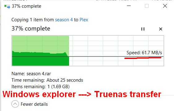

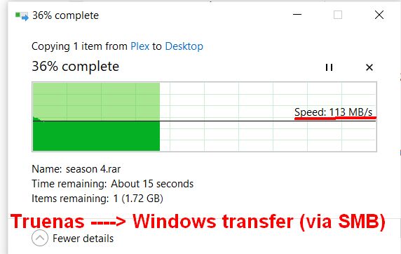

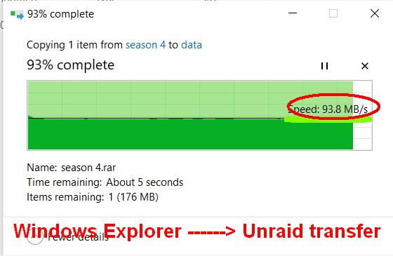

Here are my SMB transfers.
I actually was averaging about 85-93MB/s on this transfer (below)
So what does this tell us? I mean, we are practically getting 1 gig transfers via SMB in all directions?  Just  a reminder, when I did SFTP transfers from
TRUENAS ---->TRUENAS (BACKUP) I would generally saturate my network connection. I cant do this with TRUENAS to UNRAID.
