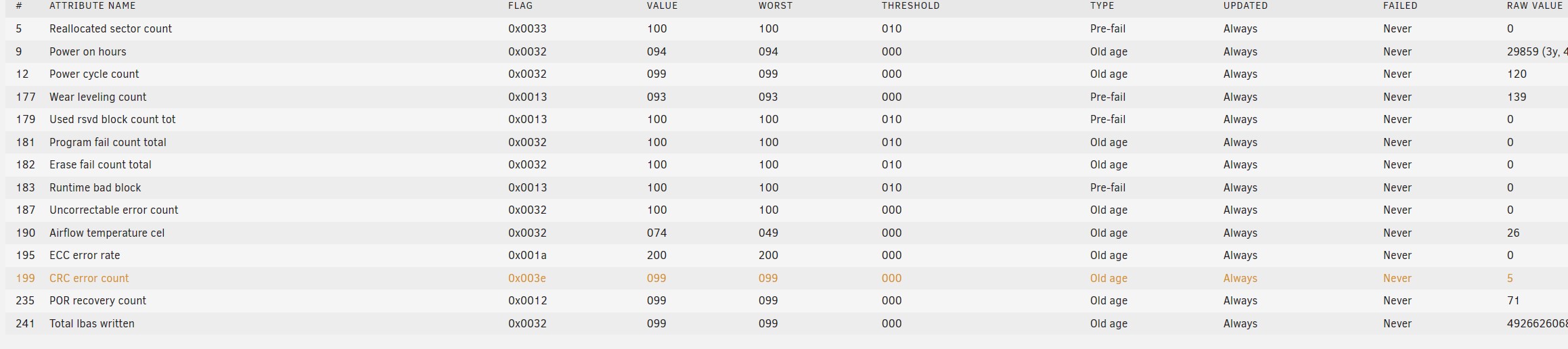

The second cache drive I added (EVO 850) also kicked out a crc error count. I'm assuming I dont want to use this drive anymore with it already having issues. Is there a particular process to remove the bad(?) cache drive I added? I have a new one coming today.
This is usually a bad SATA cable, replace it and see if the errors don't keep increasing.

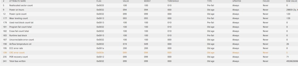

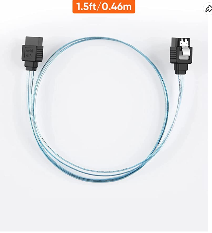

The errors have not increased since the initial install. I do have different cables to try. I had picked up some CableCreation sata cables from Amazon. No issues with the other 4 I've used in this system
I still think I may replace this drive just in case. Nothing special to do when replacing this drive? It is not the primary chache drive.
