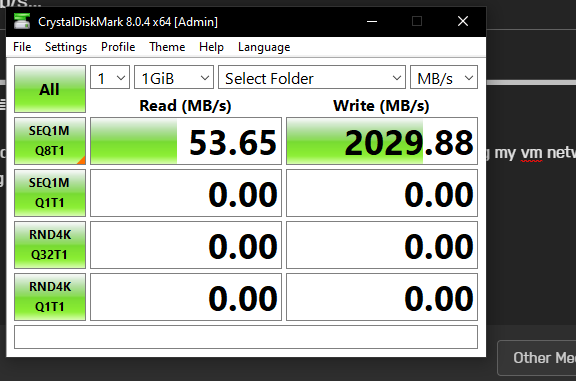

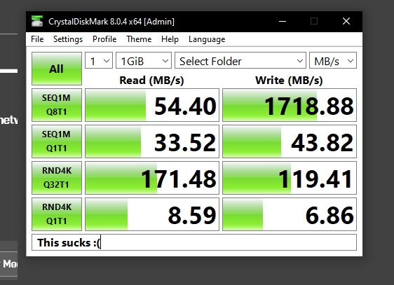

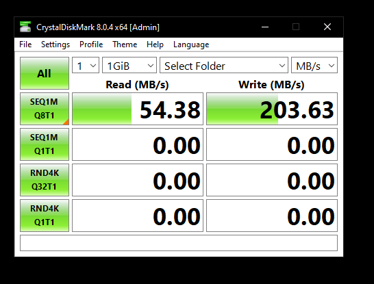

I noticed when accessing my nvme cache drive from a windows vm it was feeling sluggish. A while back I remember switching my vm network model to Virtio and running crystal disk mark and achieving multiple gig. Disk shares is enabled and I'm accessing the drive in windows via \\192.168.0.48\nvme
This is what it is now.
Nvme drive is a sn770 2tb
Thanks in advanced for any help.

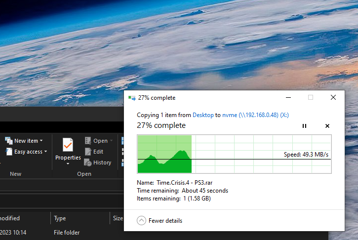

Copied a 2.2gb rar file from vm desktop to the root of the nvme. Peaked to around 70mb and low of around 20mb

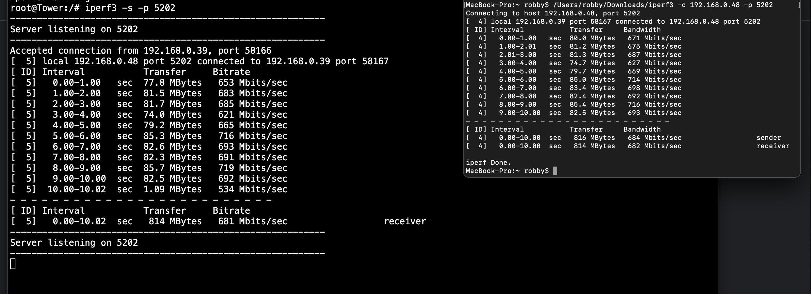

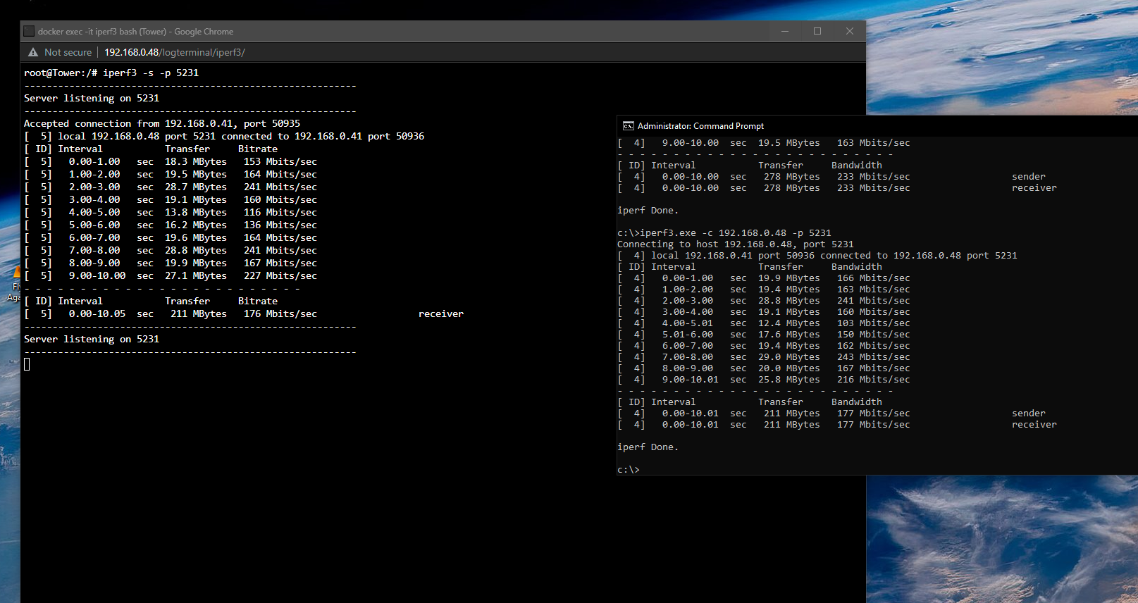

Run a single stream iperf test in both directions.

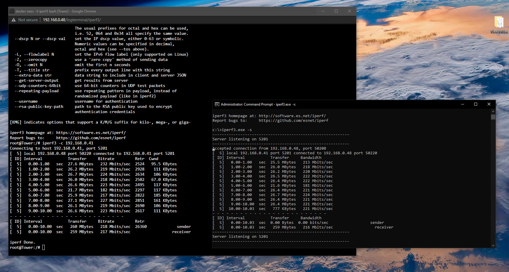

Here's unraid client and vm server.
And the other way round.
That suggests the network is the problem, I assume you are using gigabit?

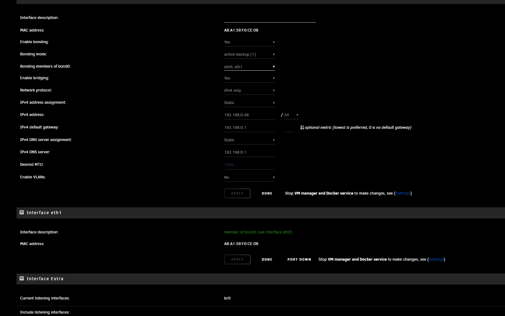

I am, this is what the settings are

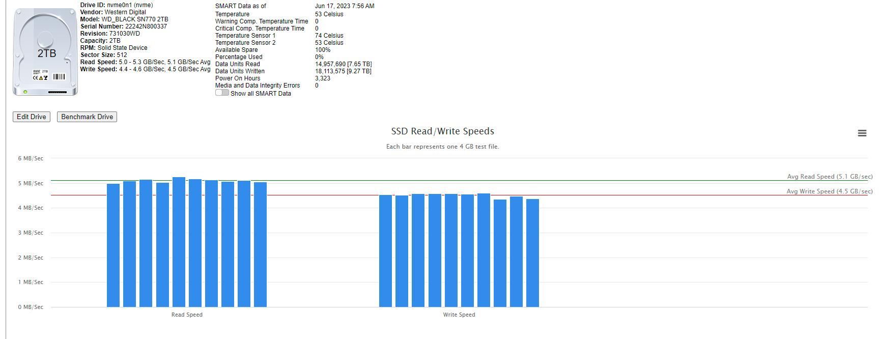

Diskspeed preforming normally
You are getting under 200Mbits, this is not Unraid settings related, could be NIC (or NIC driver/settings), cables, switch, client PC, etc

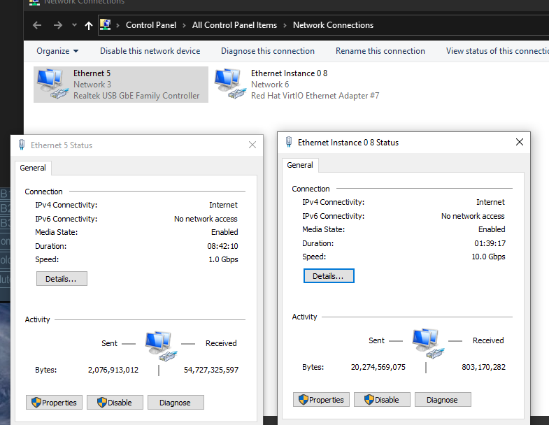

It says it has the 10gbps link
Edited by Rbby258
Yeah but that's a virtual link, a real bare-metal PC would be better for testing.

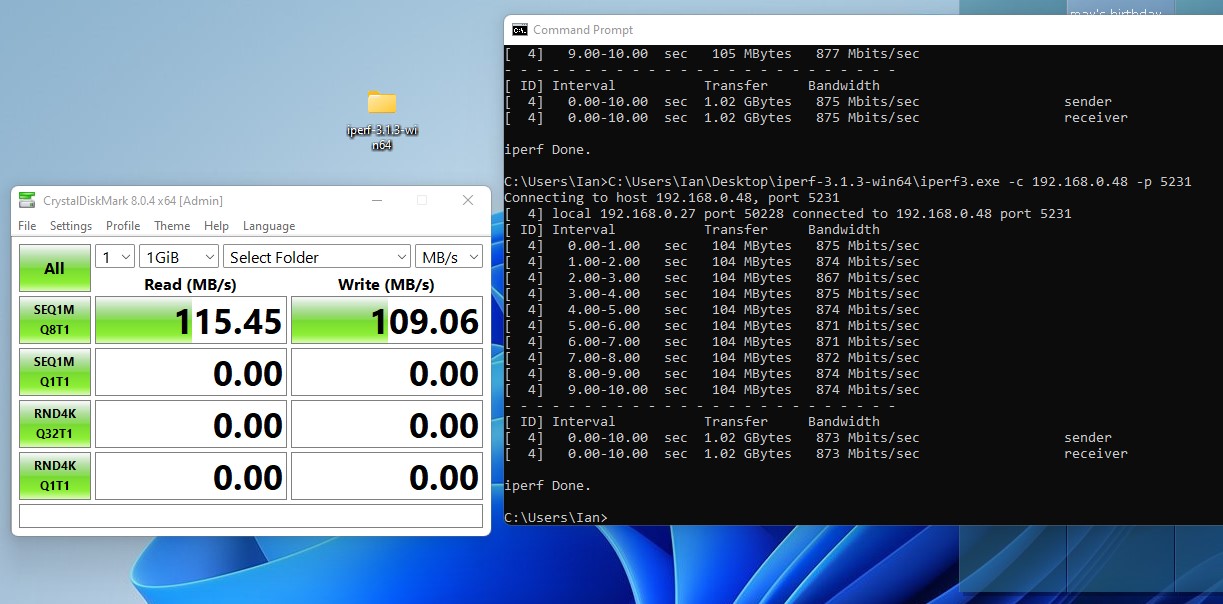

WI-Fi is not ideal but are the read speeds from the NVMe device or array are better/normal?
Here's a windows 11 machine connected to the network testing speed to the root of the nvme, hitting the 1 GbE limit.
