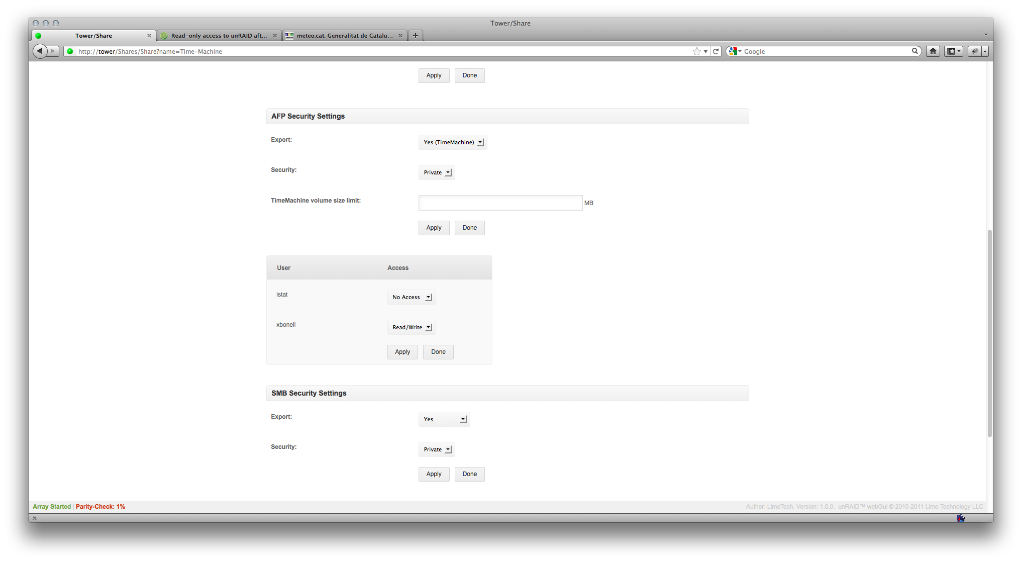

August 26, 201115 yr Author Sorry for the delayed reply, first week of work after holidays has been a nightmare. Concorde Rules, here's the screenshot of the time-machine share. Definitely something's really wrong in my server. I can read from the drives but I can't write to, neither from Windows or Mac OS X. I've double checked all the drives and they're fine: ran file system checks (reiserfschck) and smart reports. I've also tried downgrading from beta 11 to 10 and also 9 with the same results, read-only access. Now I'm considering doing a clean install with the 4.7 official release, recreating shares and users. What would be the best way for doing this? Is there a way of doing it without having to format the drives?
