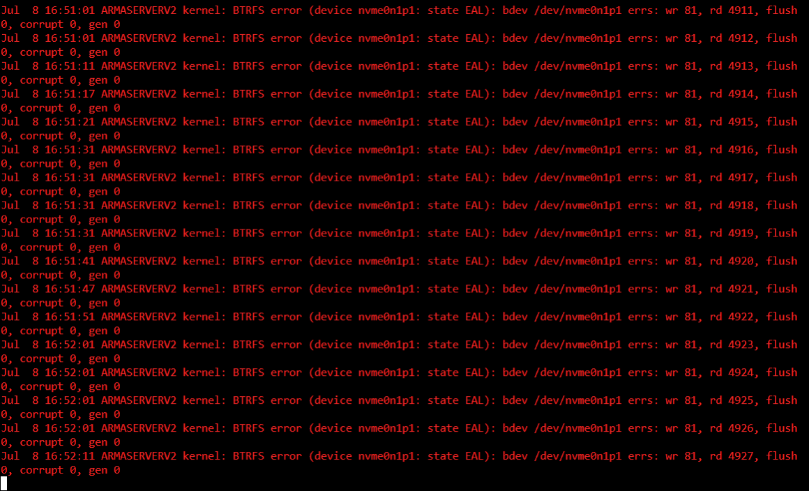

July 8, 20233 yr Hi folks, been trying to diagnose what on earth is plaguing my unraid install lately and I think I'm starting to narrow down onto the culprit. I got an error message that said something about my NVMe drive, and it mentioned __btrfs_free_ext, I've attached my diagnostics file too, if anyone can offer any insight I'd be so appreciative. I'm at a total loss right now. Thanks in advance. armaserverv2-diagnostics-20230708-1647.zip
