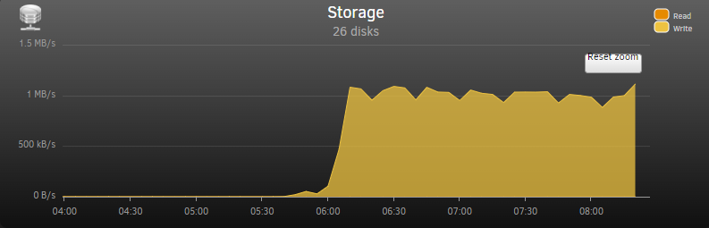

Mover very slow after update to 6.12.2
Mover is running very slowly. It has moved less than a 100mb in 3 hours. Is there a safe way to stop the mover? Attached are diagnostics and a screen shot from system stats.

You can type
mover stop
but maybe it's already stopped, enable mover logging then run it again and post new diags.
It's moving, but it's moving appdata, that can be very slow due to many small files, it would be faster moving manually.

Thank you for the help JeorgeB.  I used the file manager to move the appdata folder and now the mover is running at an acceptable transfer rate at ~ 175MB/s.
Mover is not efficient when dealing with many small files, since it first checks if the file is in use, then moves it, then repeat for the next file.
