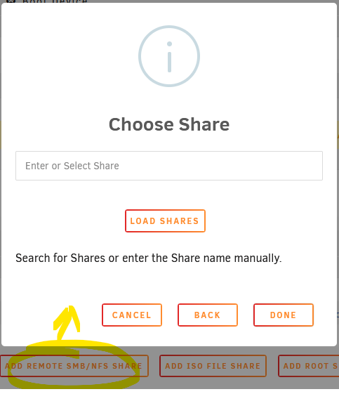

If for example i want to add a remote share, and use the GUI, this works fine:
It asks a host, user, password, and then makes me pick a share.
Remote path would be //1.2.3.4/share123/ in this example, and that works fine.
However, it requires a folder suffix.
How to add a remote share like //1.2.3.4/  instead?

I now think its just a bug that this dialog wont allow me to enter "/" or empty.
(using Unraid Version: 6.12.2 , Unassigned Devices plugin 2023.07.16)
Observations:
  1. Works when use "Load Shares", disk mounts OK if the user has read permissions for that share.
  2. The "Done" button is not disabled, but it is not working if the "Enter or Select Share" input is an empty value.
  3. If i enter "/" here, the dialog is closable using "Done" but the resulting share results in "//1.2.3.4//" (two slash suffix) and wont mount.
  4. If i enter " " (a space) here, the dialog is closable using "Done" but the resulting share is "//1.2.3.4/" which looks fine, but still wont mount and shows this error in the log:

//1.2.3.4/ refers to a server, and is not a share.  Your attempts to enter an empty share won't work.  UD accepting the " " and "/" is really a bug.  The share has to be specified and be a valid share.  The 'Done' button won't work until some text is entered.  The share field can't be empty.
