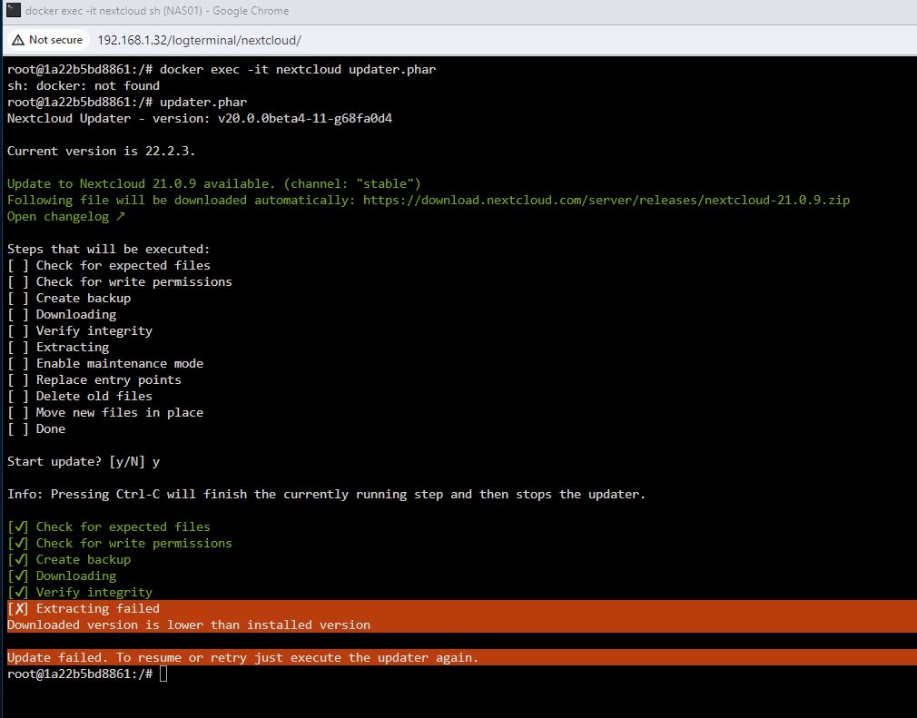

December 18, 20232 yr I'm having similar problems with NextCloud after I updated all of my Docker containers in UnRaid. I have not really used NextCloud after installing it a while ago. I suspect there is a problem because my Nextcloud installation was too old. I tried following the instructions from LinuxServer here and tried to follow the steps from @forder above. But, I have not been able to get NextCloud to start. Attached is a screenshot from the console. Can anyone point me in the right direction? Thanks.
