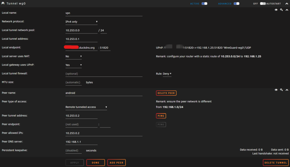

I have set up the following but still am not able to connect via android mobile - see remarks in screenshots below

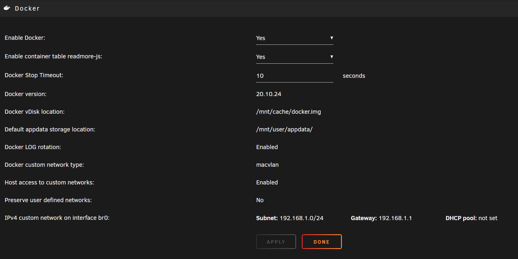

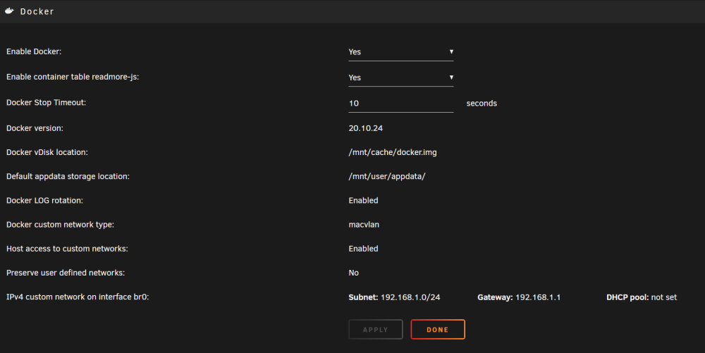

3. Enabled `Host access to custom networks:` (Docker settings)

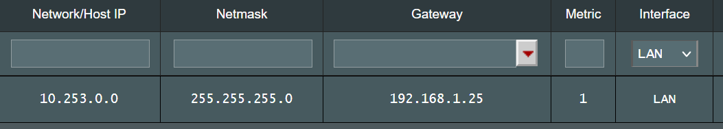

4. Routed default local tunnel network pool through IP address of unraid on router
5. Disabled `use nat`
6. Configured duckdns for ddns local endpoint (docker installed and working)
Any ideas would be much appreciated!!
Here is the routed IP address:
Here is the tunnel config:
NOTE: all addresses bar ddns autopopulated
Docker settings:
