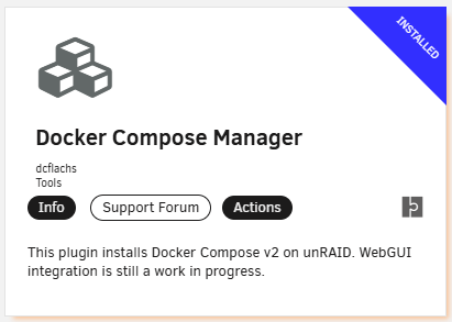

July 11, 2025Jul 11 I got this working by doing the following:Installed Docker Compose Manager from the CA Store by dcflachs, it installs docker compose and gives you a fancy gui for later projects. Open Unraid's terminal and run Wazuh's git commandgit clone https://github.com/wazuh/wazuh-docker.git -b v4.12.0Make a new directory for Wazuhmkdir /mnt/user/appdata/wazuhCopy the single-node contents from the repo to my new foldercp -r wazuh-docker/single-node/* /mnt/user/appdata/wazuh/Deleted the original git repo we downloadedrm -r wazuh-docker/Changed into the new wazuh directorycd /mnt/user/appdata/wazuhRan the certs generator command from within that folderdocker-compose -f generate-indexer-certs.yml run --rm generatorThat worked for me to generate the certs on unraid.To get Wazuh working all fancy in Unraid's GUI, I then went into the Docker tab in Unraid and scrolled down to the bottom to create a new stack using the Compose Manager Plugin we installed in step 1. NOTE: Be sure to click the Advanced Dropdown and change the path to /mnt/user/appdata/wazuh to pull in all your directories and files.Click the Compose Up button and you should be able to connect using https://insertwazuhdashboardaddresshere:5601.Hope that helps!
