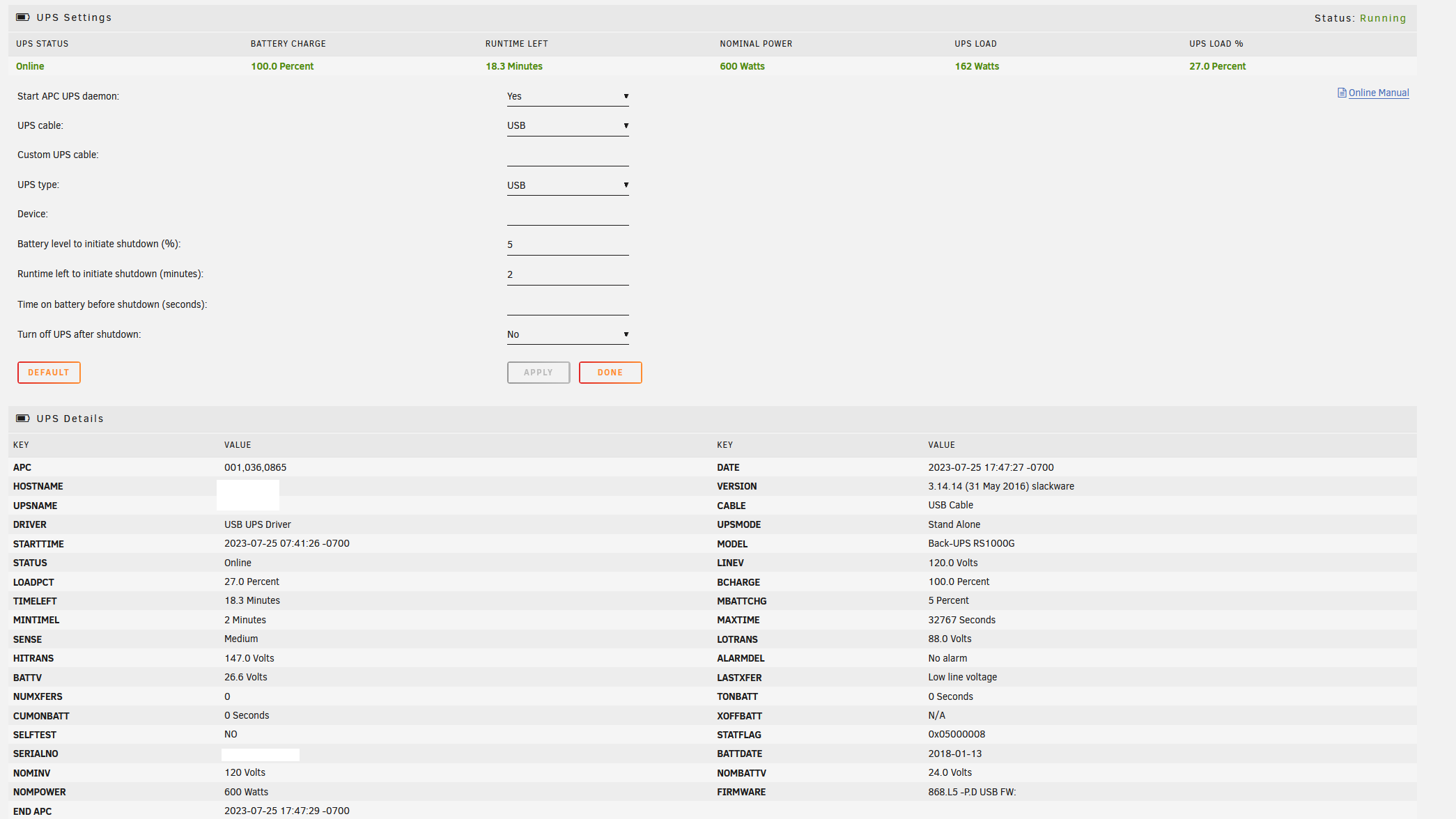

July 26, 20233 yr Author 16 minutes ago, clowncracker said: I swapped out both parity drives at the beginning of the month, but I ran parity checks then and didn't run into any issues. I did have a power outage early this morning, but the shutdown should have been clean (server is attached to a UPS). I'm looking at the logs and I don't see any mention of a shutdown. Is there a reason why the server wouldn't have shutdown cleanly? Here is the relevant log snippet: Jul 25 06:12:45 clowncracker-NAS apcupsd[25426]: Power failure. Jul 25 06:12:48 clowncracker-NAS apcupsd[25426]: Power is back. UPS running on mains. Jul 25 06:12:49 clowncracker-NAS apcupsd[25426]: Power failure. Jul 25 06:12:55 clowncracker-NAS apcupsd[25426]: Running on UPS batteries. The next log files are at 7:42:37, so I don't think it shut down cleanly. Here are my UPS settings, any reason why it didn't shut down cleanly? Edited July 26, 20233 yr by clowncracker
