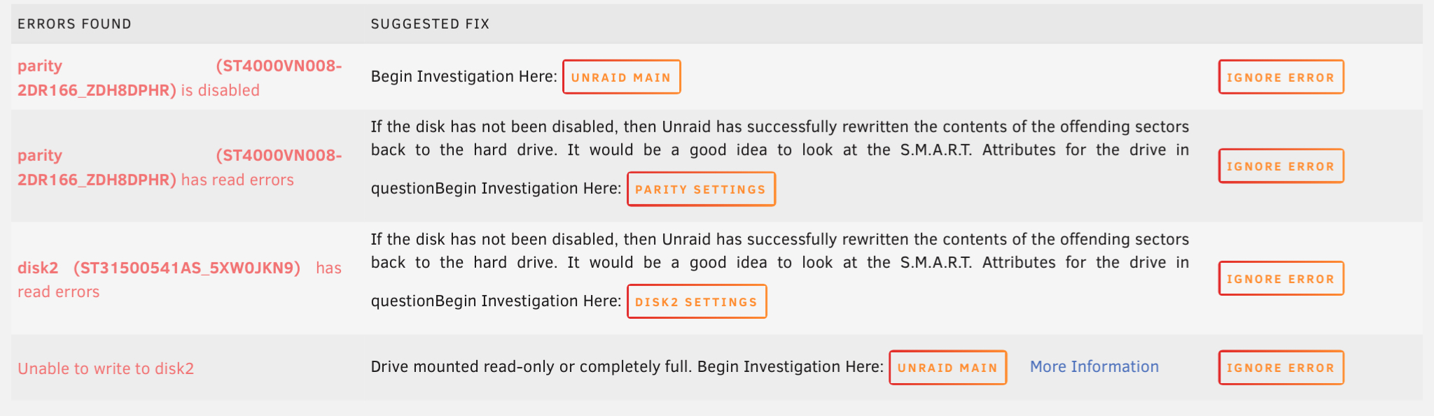

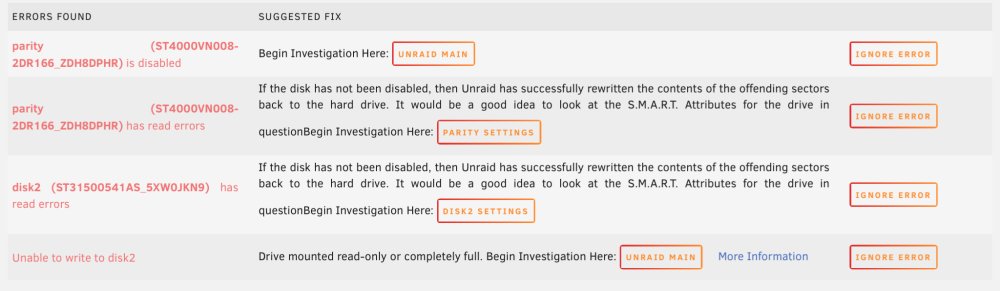

July 25, 20233 yr Hello, looking for some advice. I’m currently away on holiday and have receive notification of some issues with my parity drive and disk 2. I only have access via an iPad until I get home. My array currently looks like this, image 1 attached. And “fix common problems shows this, image 2. smart data is currently unavailable for both the drives with issues. What is my best course of action please.

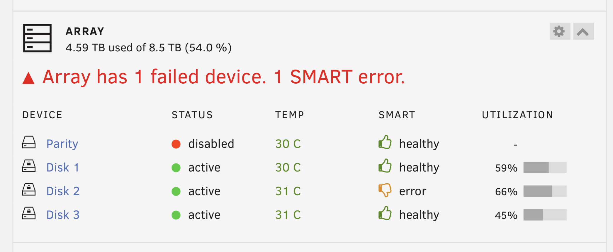

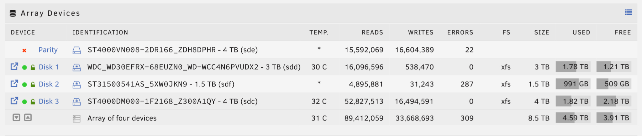

July 26, 20233 yr Author I’ve rebooted, Parity is still disabled, see attached image. I can’t do a complete power cycle for a week or so.
