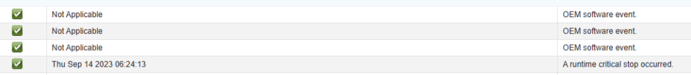

valiente Posted September 14, 2023 Share Posted September 14, 2023 I just got this same issue for the first time this morning: Also, on 6.12.4 but only thing that is different is last night I had an unsafe shutdown, which corrupted my docker.img - I rebuilt this around midnight and got all containers up and running. About 6 hours later I see the server is dead with this same error. Obviously all docker settings reset to default, and mine is set to macvlan now. Will also be trying ipvlan - Can't remember if that is what I used to have it on. Quote Link to comment
VladDT Posted September 14, 2023 Share Posted September 14, 2023 1 hour ago, valiente said: Will also be trying ipvlan - Can't remember if that is what I used to have it on. Just stop raid and set it in advanced docker settings. Quote Link to comment
