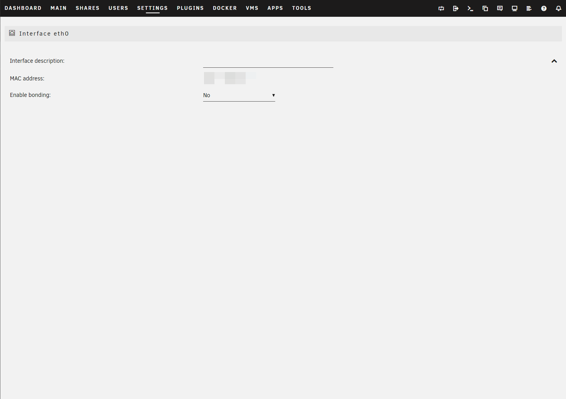

I have 2 NICs on my server, one have 4 1gbps port and the other is 2*10 gbps port. Here are the bisic info.
As you can see, eth0-3(1gbps) are dynamic link aggregation (bond0) and eth 4 & 5 are fault-tolerance backup (bond5). Both of the bond work fine and I can access the searve with any of them. However, I can not get the network setting page load correctlly. It stops load after few lines. Like this:
I check the F12 page, looks like there is an error but I don't know how to fix it.

Solved by JorgeB
Try renaming /boot/config/network.cfg and reboot, settings will go to default DHCP, then reconfigure.
Thanks. This did help for the Web Ui issue.
