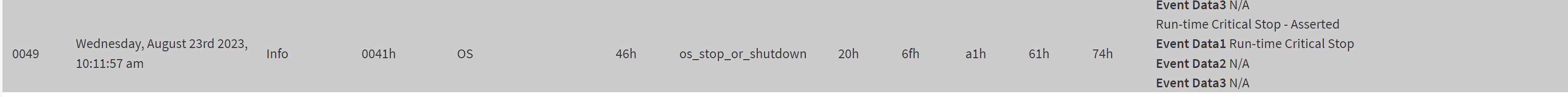

August 23, 20232 yr Author So the server locked up today again requiring a hard reset, I looked at the syslog and there was nothing there so I looked in the IPMI log and I do see the below. I don't know how to figure out what is causing this. 0049 Wednesday, August 23rd 2023, 10:11:57 am Info0041hOS46h os_stop_or_shutdown 20h6fha1h61h74hRun-time Critical Stop - Asserted Event Data1 Run-time Critical Stop Event Data2 N/A Event Data3 N/A
