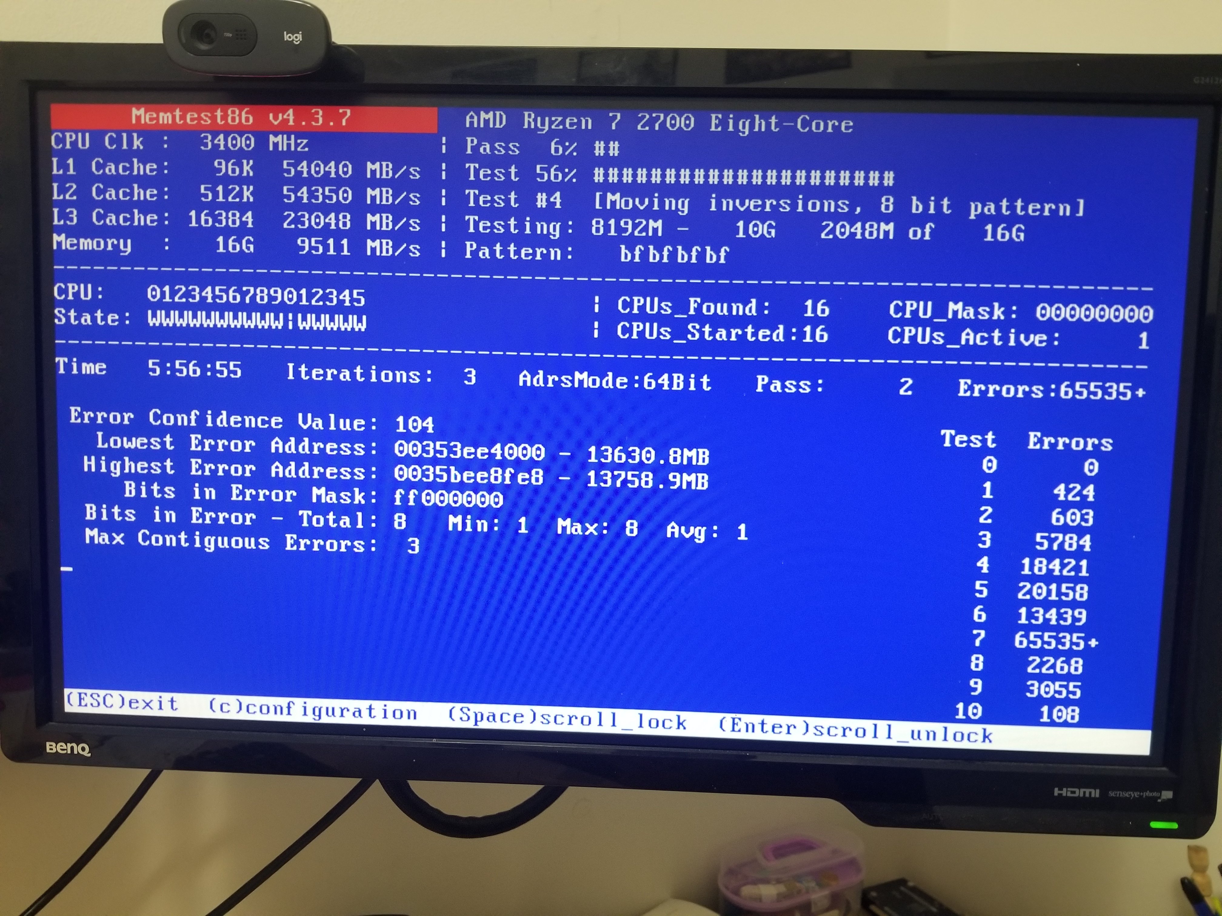

Thank you for your reply I downloaded memtest86 V.4 and am running it with one RAM stick and 5 min in it already shows 6k errors. Will post again after running test on both sticks.
Hello, I have run memtest on fist stick and received the results in the picture. Running memtest on second stick and 1. hours in and there are no errors. I believe I should replace the first ram stick, and what else??
Replace the RAM then run a scrub on the pool, then probably best to recreate the docker image.
