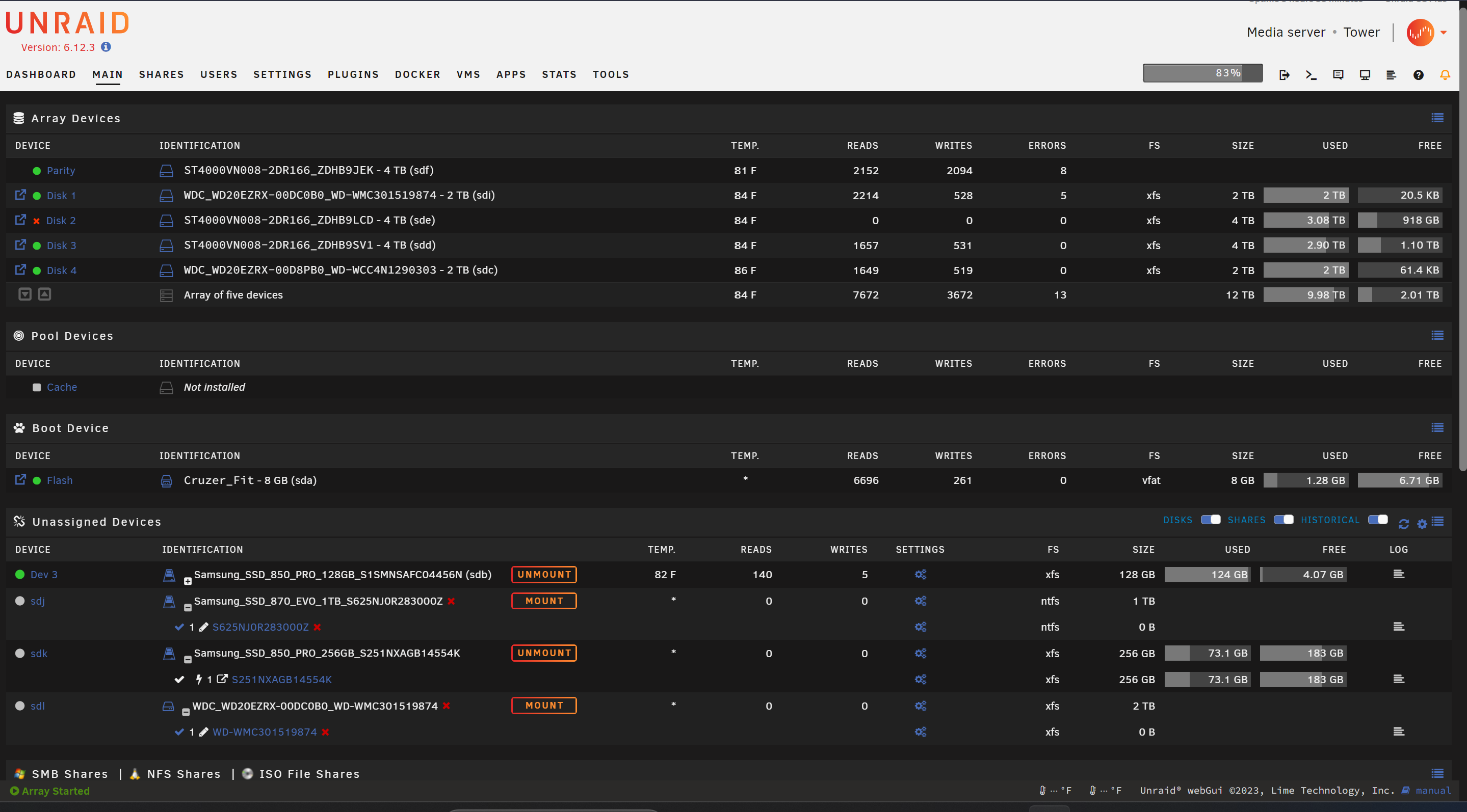

August 25, 20233 yr So recently, I had to power down the server because something was hung to the point where the GUI and my ssh session were very slow to respond. After it came back up, I'm seeing a disk read error in syslog, most of my docker containers can't start (two of them claim to be started for some reason ¯\_(ツ)_/¯) because of a 403 not found error (because it can't see the disk apparently), and VM's page is empty. Also array disk 1 reports to be fine, but is also showing up under unassigned devices. If I cd to /mnt/disk1 and run ls -lharts I get this: "/bin/ls: cannot open directory '.': Input/output error". I immediately get worried because array disk2 was already being emulated and I'm waiting for a replacement to show up. At that point, I restarted in safe mode and started array in maintenance mode to run xfs_repair on suspected problem disks and all apparently went fine. I could manually mount disk1 to a created mount point and was able to pull the data off just to be safe. I restarted the server and it's all still borked. Would it be best to do a new config at this point? I don't want to lose data, but I do have all mission critical things backed up. I still don't want to have to recreate all my media if there's any way around it. My diag file is attached. Thanks in advance for the help! tower-diagnostics-20230825-1119.zip Edited August 25, 20233 yr by Mobius71 typos

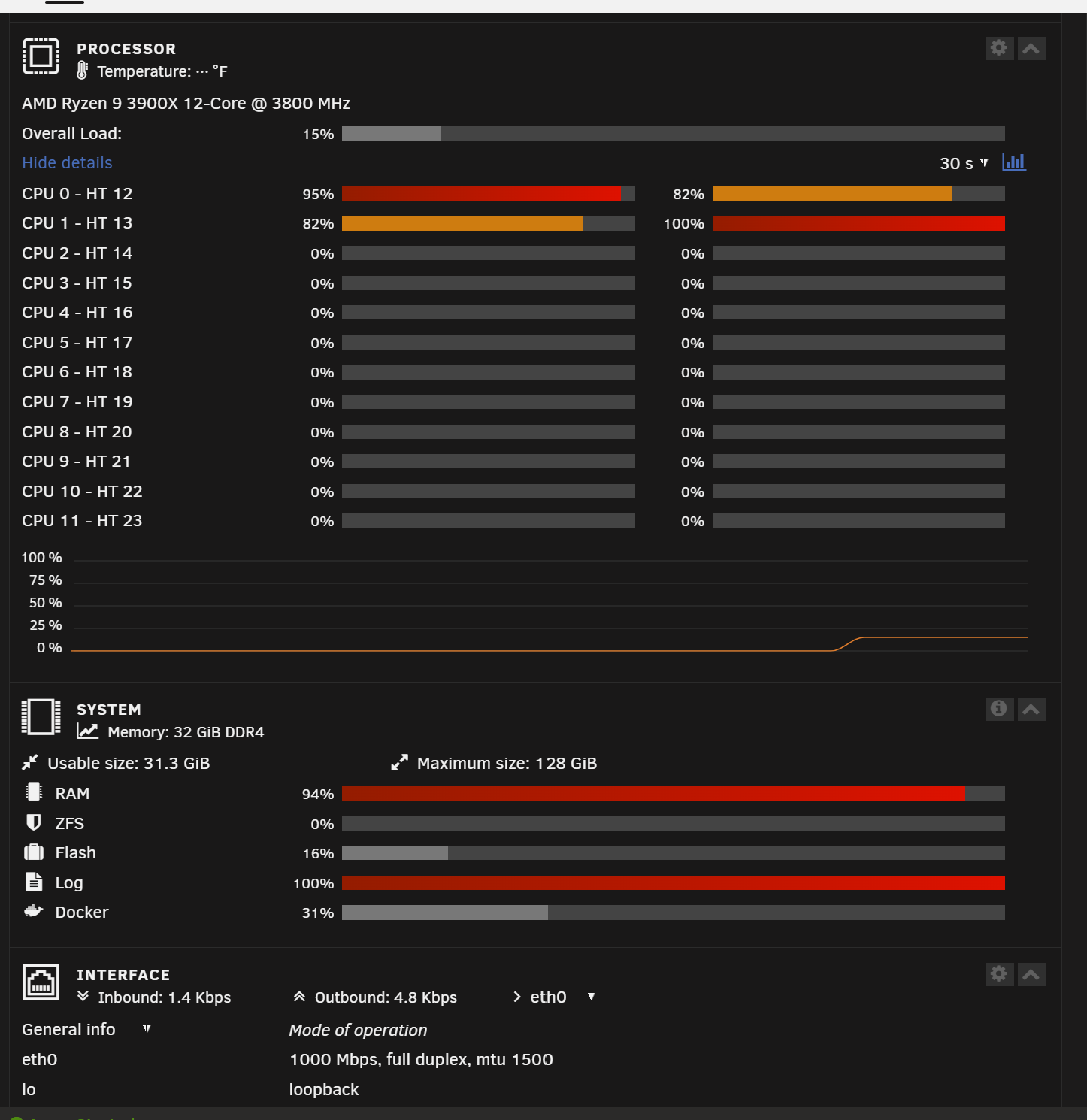

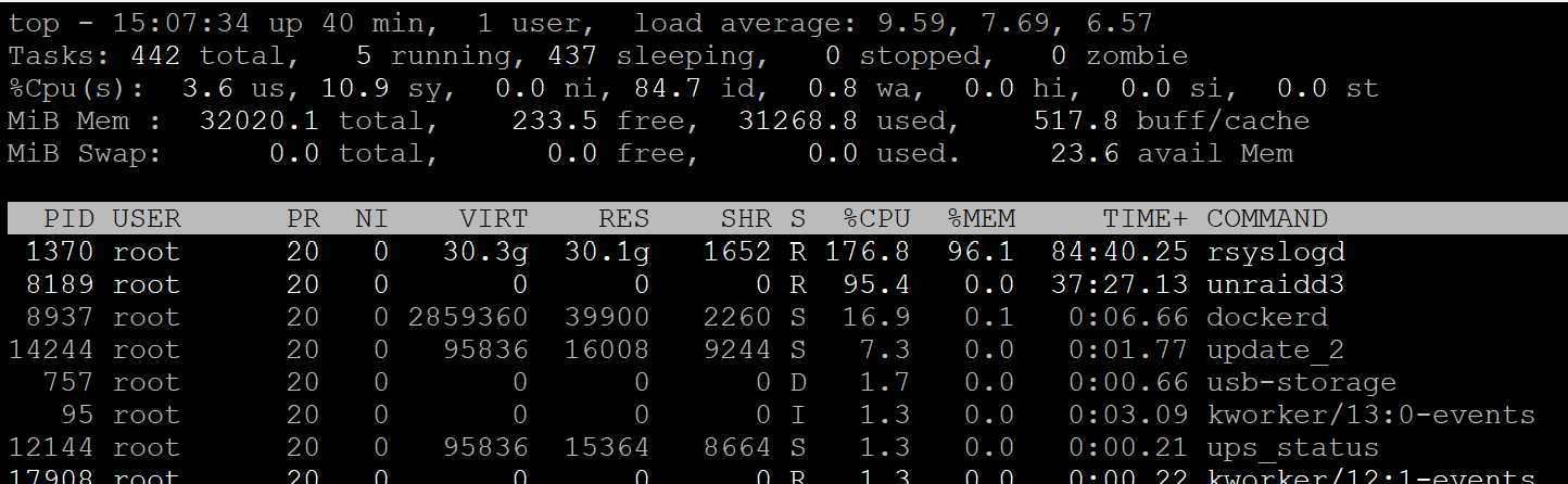

August 25, 20233 yr Author Also seeing high mem and cpu usage: I have those 4 cores locked to the OS so I can use the rest elsewhere. Also the log is at 100%...so looks like syslog is going crazy and eating up resources. Gonna shut things down for now. Edited August 25, 20233 yr by Mobius71
August 25, 20233 yr Author I couldn't access the vm config to turn off auto start until I killed rsyslogd. Then the GUI began behaving much more normally. I turned off auto start for VM and rebooted the server. New diagnostics file attached. I'm still having most or all of the same issues as before. Log immediately gets filled with "Tower kernel: md: disk0 read error" tower-diagnostics-20230825-1801.zip Edited August 25, 20233 yr by Mobius71
