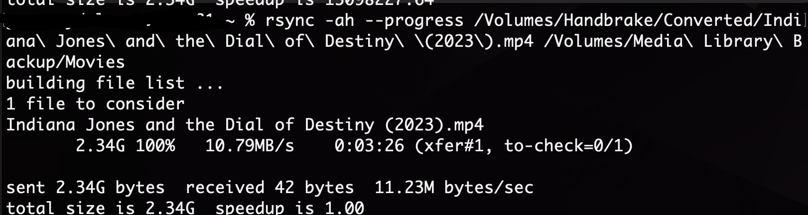

I have been plagued with slow transfer speeds for a while and I feel like I have done everything from across forums to speed them up. In the below example, I am copying a 2.34 GB file from one folder on my cache drive to another folder on the same drive. It takes 3.5 minutes to transfer from the same drive/device (not including mover piece). I have....

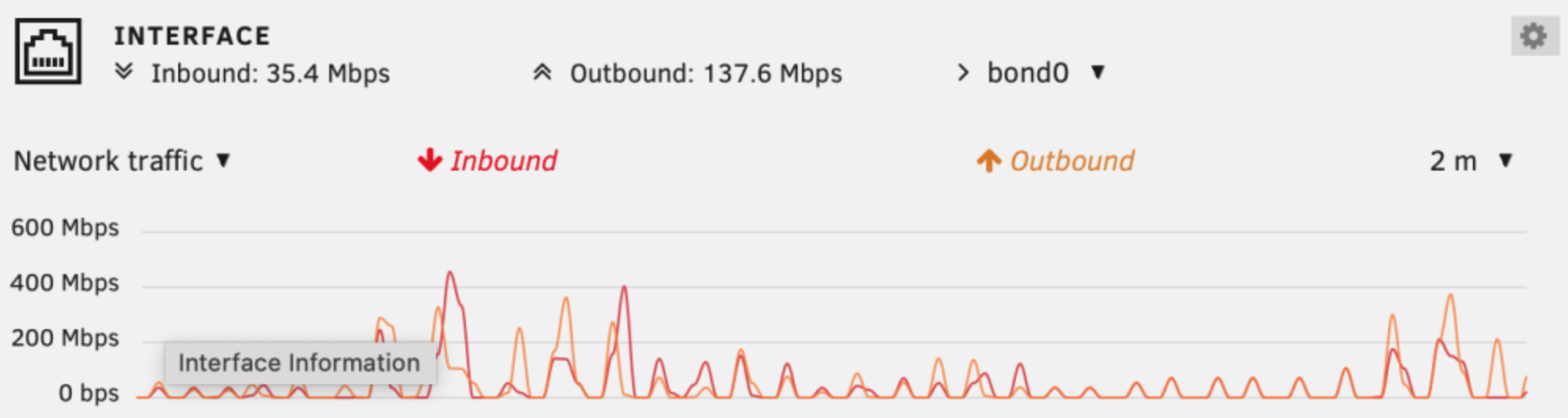

Also, this looks wonky right??. This is AFTER I rebooted my server and did a copy of the same file. Keep in mind, this is just copying from one folder on the cache drive to another folder on the same cache drive.

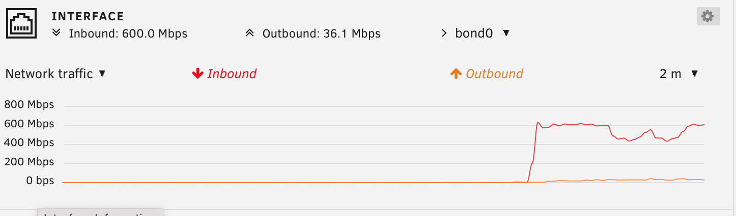

Even more interesting, here is what happens when I copy a Parallels VM file (roughly 30 GB) from a client computer (MacBook) to the server's cache drive. It was CRUISING! This is how I expect it to be all the time. 1849721858_Screenshot2023-08-31at3_27_20PM.thumb.png.09a2c5f1e42e16c7eb581f82adb356af.png
What is the OS used? Copying a file from one device to another should not use the network, at least with Windows and Linux.
