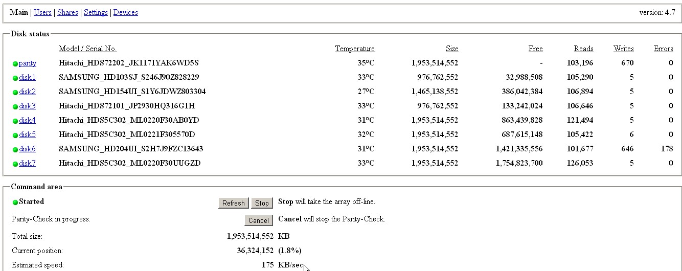

Also, the parity check-no correct is running really slow <see attached>

With the syslog errors you are seeing, I suspect some kind of cabling problem to the drive (either sata or power connection may be flakey).  I'd try reseating the drive and replacing (or resecuring) the cables and run a few parity checks to see if the problem is fixed.
Thinking along the same lines...except the pending sectors have increased from 0 to 14 to 40 in the last 2 hours.
Checking cables once the daughter finishes watching a movie. <why now? ;D)
an_hour_later_smart.txt
Have a replacement on the way..
