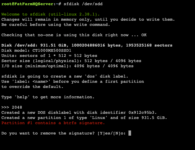

No partition exists on either device, suggesting they were wiped, depending on how it was done it may be recoverable, type
sfdisk /dev/sdd
then type
2048
and hit return, finally post a screenshot of the results.

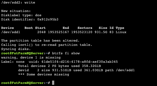

Hit N + return to keep the signature, then type
write
and return again, then
btrfs fi show
I’m not familiar with everything you are instructing, but it looks promising to me. Should I try mounting sdd1 again in the cache pool?

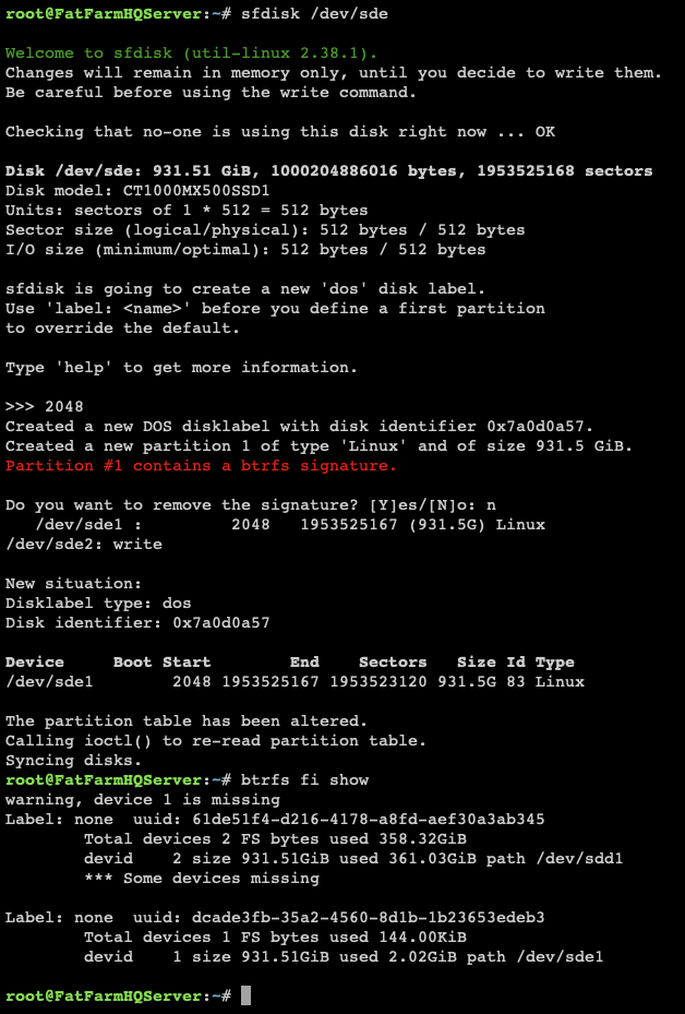

First lets see if you can also recover the other device, in case there's an issue with that member, do:
sfdisk /dev/sde
and assuming it finds a btrfs signature follow the same steps above, then post once more
btrfs fi show
Here's the results. Thank you for your persistent help with this.
The 361gb on sdd1 is my previous cache. I think that the 2.02gb on sde1 is from a 2nd cache pool I started on that drive only during my troubleshooting and testing. If that's the case, that data is not important to save. I think that it might be best to just get sdd1 up and running the cache pool reliably, then I can just format sde1 and add it to the cache pool.
