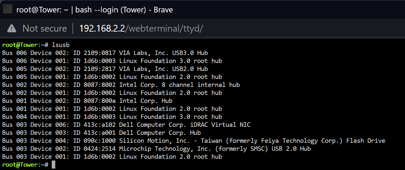

no command lsusb

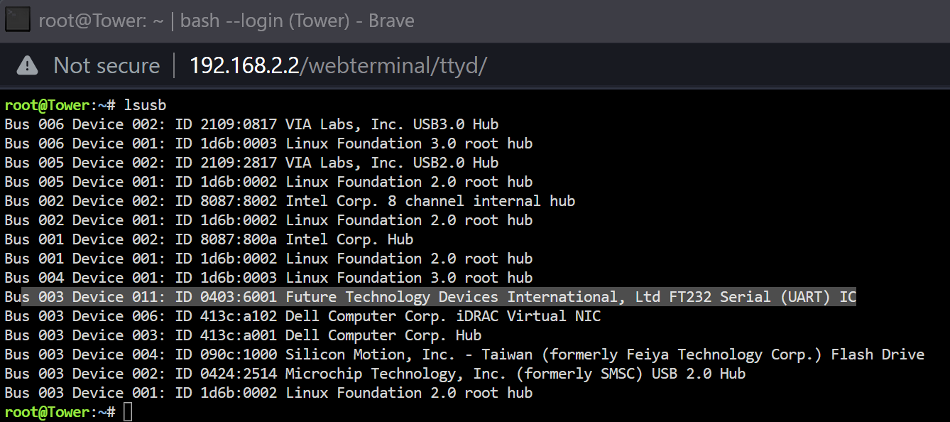

Which os vers are you running? I would expect the usb serial adpaters to show in lsusb. Are you able to try on a port not on pci card to see if they show?
I'm running 6.12.4. I can try real quick.  Give me a minute
I think its that one.  On a side note how do i translate info from that in to figuring out what goes here: /dev/ttyS1
3 hours ago, TheIlluminate said:
ls -l /dev/serial/by-id
This should show the serial device.
Looking at the amazon post does not seem to support linux so may not be a driver.
Honestly didn't even think to check for that...well crap.  Sorry for the stupid question and thanks. You wouldn't happen to know a PCI to USB card that actually works would you?
