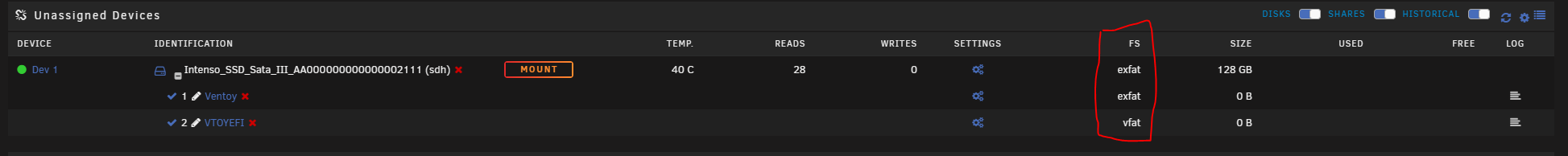

First, install the unassigned devices plugin.

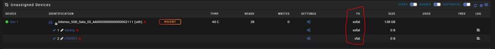

Then, on the main page, you should see all currently not assigned drives listed under "Unassigned Devices"
The red square above will tell you which of the drives has a filesystem, so you can already pick out the drives that are actually data containing drives.
