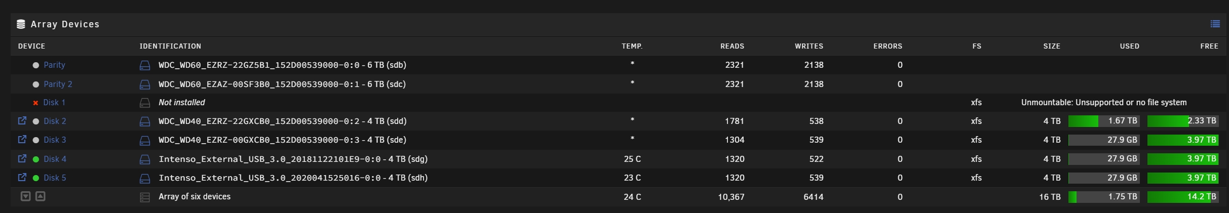

Hello
my array has a corrupted disk and i had to chance this
i had removed the disk from the array und startet it again
he says the disk is now emulated, but on the right side it say Unmountable: Unsupported or no file system and so i cant access the files from the emulated disk
i dont know what to do now.....
hope anyone can help me, there are many needed data on this :(

thats the output without -n :(

Post the current diags.
There are no disk errors logged, suggesting a xfs_repair problem, so not much more you can do, except maybe waiting for a newer xfsprogs release in case they fix that issue, other option is to post in the xfs mailing list to see if they can help.

Parity cannot help with filesystem corruption, another option would be to use a file recovery util like UFS explorer, there's a free tril that should show if it can recover the data.
Hello, I was able to save a large part of the data using data recovery tools.
Not all of them, but at least a large part, thanks for the tip.
How do I proceed now? because disk1 (from parity) is still unmountable.
should I format this now? and then put in a new disk?
or create a new config and have the parity completely rebuilt?
best regards nowaczuk
You can rebuild the disk and format, or the other way around.
ok, thx for your help :)
