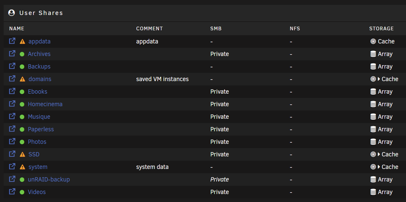

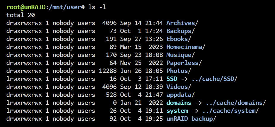

I enabled the exclusive access property a few days ago (following an update from 6.11.x to 6.12.4), which is working on my other three shares on my NVMe SSD, and I can see the symlinks there :

Since I'm afraid to delete this directory, I tried renaming it aggressively :
mv /mnt/user/appdata/ /mnt/user/appdata2/
But it didn't change anything except the directory was also renamed on the NVMe SSD (I renamed it back to /appdata).
