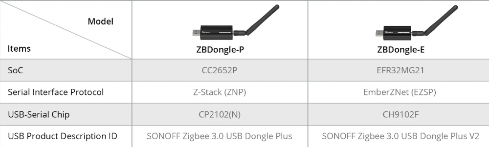

How do I get my Sonoff Zigbee 3.0 USB dongle to work in Unraid?  I have it plugged into my server but I'm not sure if the device is working.
 In home assistant I'm not sure what radio to use.  I'm running the docker version of Home Assistant.
Solved by Vr2Io
Add the device to HA docker. ( I only try HA docker to handle the dongle in early testing and I use Zigbee2mqtt currently, so it may have some different, anyway almost that way. Or you may ref. below youtube clip )
Depends on which type Sonoff dongle, integrations / config it with correct protocol ( ZNP / EZSP ).

Thank you for your help on this.
I have it setup properly now.
